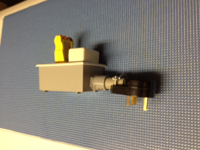

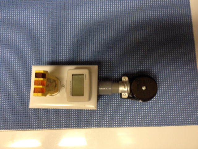

This is an electrical tester that I put together from directions on some RV forum--maybe this one, but I can't remember where it came from.
It is simply a 30 amp male plug mounted to a pvc receptacle box with the standard receptacle inside.  Plugged into the receptacle is a standard receptacle tester which shows polarity, grounding  and hot/ground or hot/neutral reversed.  the second (white) item is a voltage indicator .
I'm sure there are probably more sophisticated instruments available, but I made this one for about $30.
