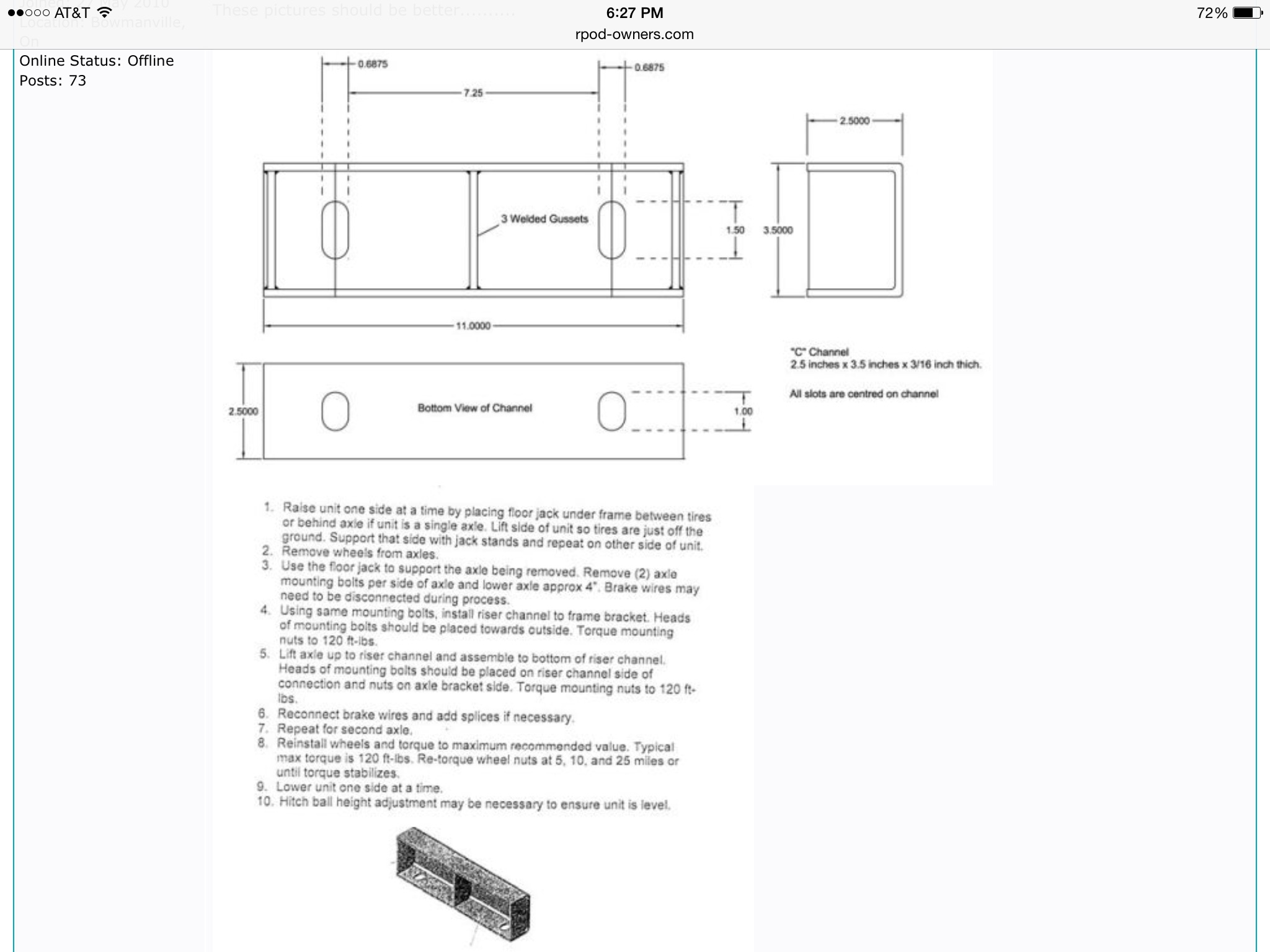

Oosiker, I spoke with Amy at Forrest River today and got the same info; no supplier.for the risers I've spent the afternoon calling every Forrest River dealer I can find online with no luck for on hand stock. I have a 2012 R177. Amy told me based on my VIN I should have a Dexter axle. The factory part number for the riser kit for this axle is 10F10587A. If you locate a kit or are able to have a set of risers fabricated I need a set too. I'm attempting to attach a drawing of the deminsions for a riser. The poster didn't specify which model these are for but it was posted in this forum in 2011. Good luck with your search!
