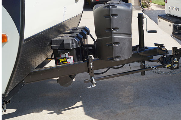

I went with two Trojan 6V golf cart batteries and with the dual propane tank setup. I don't notice any weight issues, but I do have a WDH.

Which Trojans did you buy. We have the t-125 and there doesn't seem to be enough room for both cases
