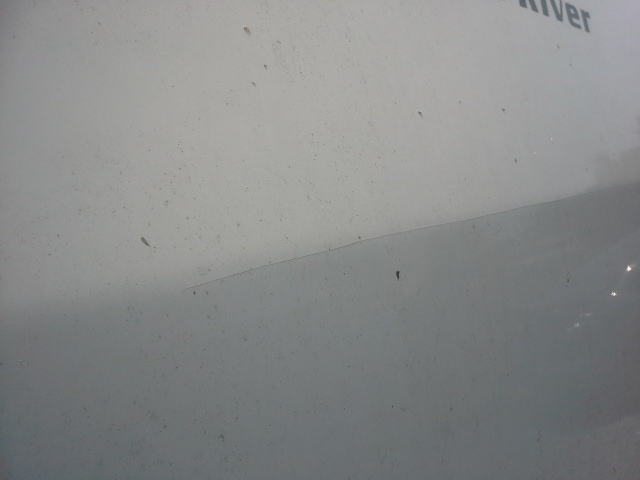

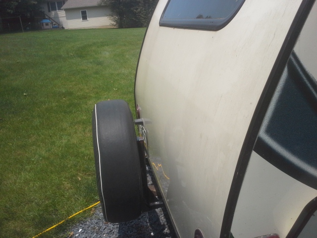

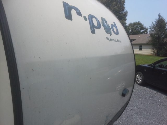

I took some pictures of the crack and the ridge. I thought I would post them to give other members an idea of what to look for.  Picture one is of the ridge located just under the R-pod sticker. you can see it runs almost the full width of the camper. picture two is a closeup of the same ridge showing the hairline crack. Picture three is of the back of the R-pod showing the other ridge. It's a little harder to make out.  Markie

   I would agree with Doug in that Rorest River may fix it. We live in a warm climate I wonder if we had lived in a colder climate when we owned our 171 the cold weather would have cracked ours. The picture of the back of your r-pod looks like the crease we had on ours.
