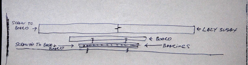

Yes biscuits & glue and then screw to board.

How did you join the two halves? biscuits & glue maybe?

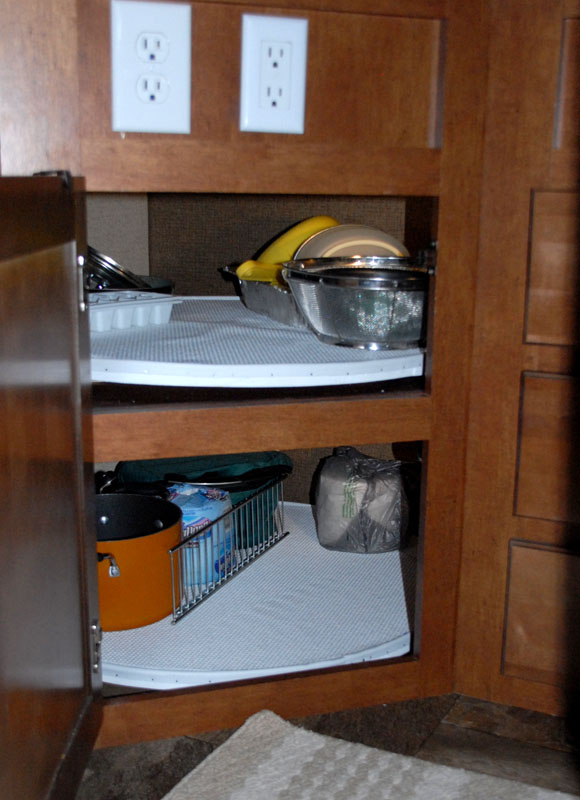

The finished lazy susan is 28" dia made from bearings I ordered on amazon and 3/4" plywood from home depot.

We hate to see a large storage space wasted so I installed two large lazy susans. Both rounds were placed inside storage area in half's and then joined together.
