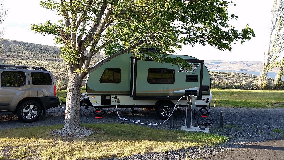

Fuel4Humans, as you can see by my profile, I also have an XTERRA, 2008.  If you have the factory installed towing package, you'll have no problem.  You can expect your MPG to drop to about 13 MPG, or less.....that's how it goes.  It's a good idea also to get an electronic brake control for the vehicle.  I've had mine out only once so far, but it did fine on the interstate, I kept it to about 60 - 65 mph, in a 70 zone, and let all those in a hurry zip on by...!
Here's a couple pics:
2016 179 - Hood River Edition
2008 Nissan Xterra

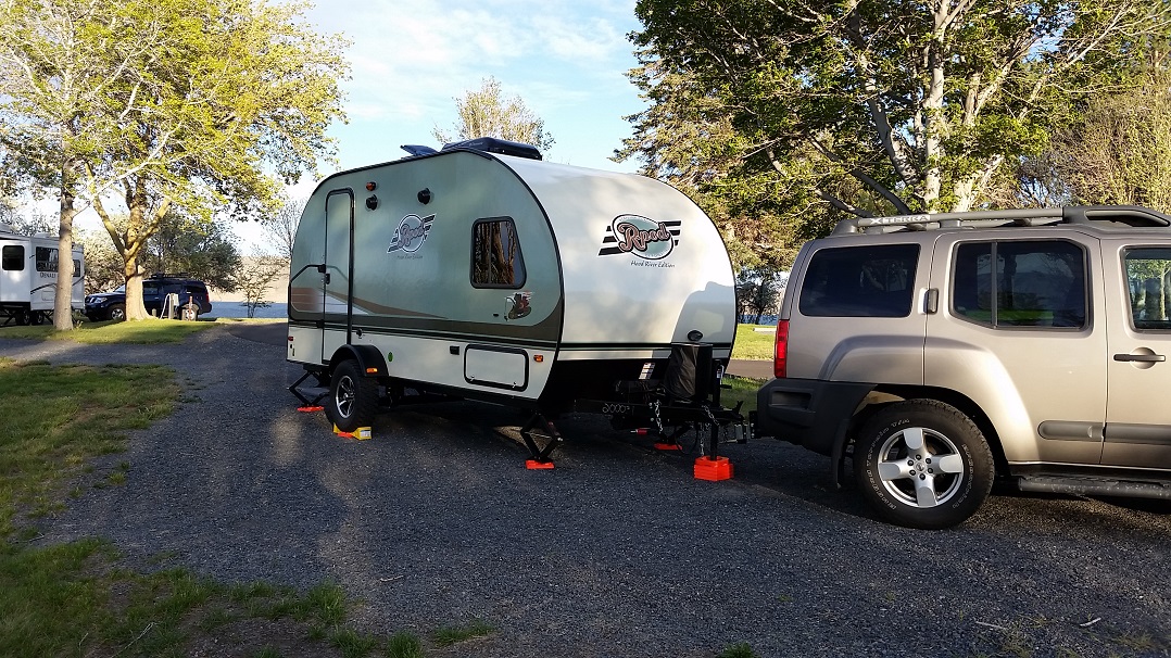

Direct Link To This Post Posted: 09 May 2015 at 11:19pm
Hmmm...only one pic went thru...so here's another:
2008 Nissan Xterra
