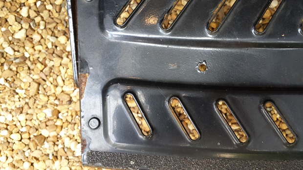

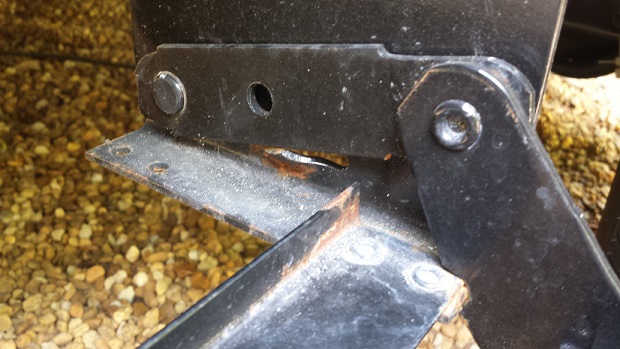

2. Just noticed steps are already peeling paint and rusting.

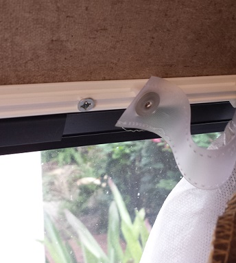

3. Curtains in kitchen will not open, tore trying, as the screw heads are too large to get past. Yes, I have tried screwing them in further. Also tried purchasing screws with smaller heads, was unable to find them. Seriously, WTF.

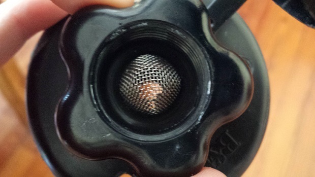

4. Had to purchase and replace the entire city water intake as water squirted out when water pump used. A piece was completely missing.

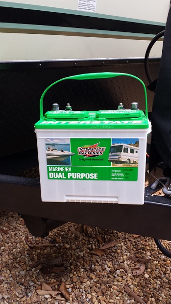

7. Last but not least, my battery would not hold a charge so I took it in today and they said it was fine but that I have a "Dual purpose" battery instead of the "Deep Cell" that was shown on my purchase order. Per Interstate, big difference.

On the battery, while I like a true deep cycle myself, your "dual purpose" battery, well one of the dual purposes is.. RV.. Hard to get to bent (IMHO) about an RV battery, in an RV.

A question on "battery would not hold a charge". The battery you show should run the 12 volt stuff in the pod (with the fridge on LP and not DC mode) for several days. How long does it last? Have you kept the battery on a trickle charger or the pod's converter since you picked up the pod, or have you charged it overnight every 30 days and then disconnected the battery?

To techntrek, regarding the battery, I took it on a trip and with the fridge on gas, it lasted one day and we hardly used it. I was at a music festival and was gone during the days. Once it stopped working, I would run the car and charge it to at least 2/3 and by the evening it was all but gone. AND we weren't even at the campsite. Is the battery in the photo correct? Is there something draining it that I am unaware of? My invoice says "Deep Cycle" battery.
