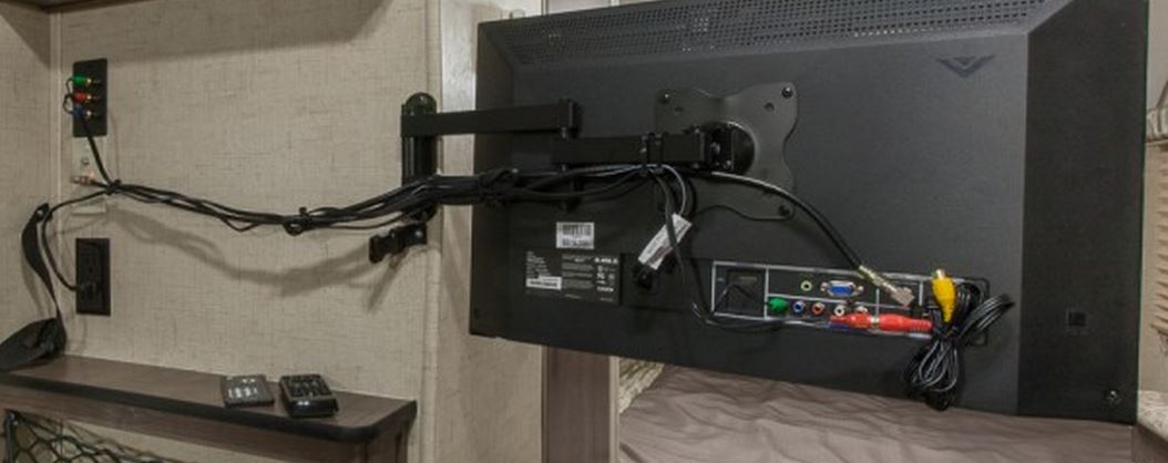

That sounds very easy to do. I wonder is Jensen assuming that all r-pods have these rca cables installed thru the body of the pod (my 2014 177 has only 1 rca type cable pre wired it is yellow from the back of stereo on video out to the wall plate marked tv video out then hooked to AV section that has 3 connectors marked V L R it came hooked in V . all of your rca cables are hidden in the walls aren't they Thanks to everyone very much for all the help

Posted: 26 Jan 2015 at 2:49pm |
Originally posted by coledj
...all of your rca cables are hidden in the walls aren't they |
No, you should see RCA cables from the plate to your TV. Y (video) W (L. Audio) and R (R. Audio).

Posted: 26 Jan 2015 at 5:40pm |
Thank you 1 photo is worth a thousand words that answered my question my 177 does not have that wall plate or rca cables any where in the trailer. it must matter what mood they are in on any given day. I see many things different on the same models. My only choice now is to try and run cables thru opening's inside the wall. I will run cables on the floor first to make sure it will work. Thanks for all the reply's
