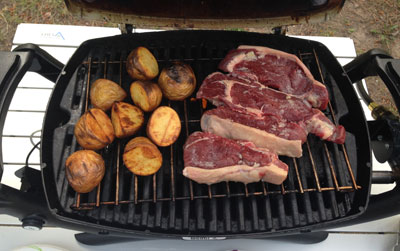

Ahhh! Buffalo steaks and roast potatoes on the Q in Custer Sate Park. The good life!
![]() I travel with a One Gallon Worthington tank for my Q and a Coleman High Pressure Hose I haven't had any problem getting the one gallon tank filled, but have heard of issues. It also serves as an emergency backup for the pod 20 pounder. On a month long cross country trip I refilled both tanks once. After breaking two of the Weber branded plastic adapter hoses, I have found the Coleman "wheel" adapter to be much sturdier. I also found a plastic tub w/lid @ Lowes in which the Q, hose and BBQ tools fit perfectly and stow in the back of my TV w/no odor. Wouldn't leave home without my Q! Fred |
