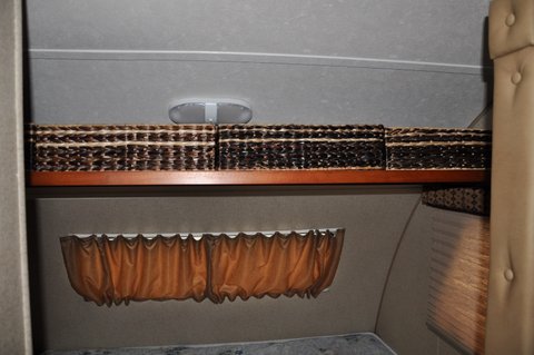

On our last trip we tried out the ole shelf over the bed with baskets mod so many other podders have done. Cost was about $110.00. It offers plenty of room for 4 real nice sized baskets to hold clothes and access is very user friendly. I will say that the mod is probably at least a 5 out of 10 for level of difficulty. Like many others, we found the perfect shelf at Lowes, the finish basically matches the bathroom door perfectly. The baskets were a little harder to find but we got lucky at Michael's with a 50% off sale. WARNING to people who do not normally buy baskets...prepare for sticker shock! Good baskets are expensive! No more digging in duffles for socks for us! YAY!

Is the shelf you found solid or not?  do you have a part number from Lowes?  How does one attach it to the walls?  I just got my rpod so if this has been discussed, sorry, or send me reference.

I used 3" L brackets. The shelf is part of a closet storage system, sorry...I don't know the part number. The trick was finding the right location for the shelf vs the type of baskets to be used.
I'm real happy with the way it looks and the functionality. It's like having the space equivalent of a small 4 drawer dresser.

Cliff: Outstanding! Hope you won't mind if I shamelessly copy your good idea! And Lowe's, BTW, has a decent selection of baskets. We're leaning toward wicker-styled plastic ones rather than the actual wicker.  I'm a little concerned that the real wicker might snag my "dainty unmentionables". LOL
And John in Idaho:  Here's a link to a Roth & Allen shelf at Lowe's that sure looks like Podster's.  Hope it helps.  The shelf is 6' long.  The width of our Pods is ~6'2". So, it looks like it could get some support from the window valance plus additional from the 3" L-brackets Podster mentioned.  I'm thinking some 1x4" cedar (or whatever) might make a good shim at each end.  Would mean a little less weight on the valances.  Anyway, I'm thinking out loud. Sorry.

That's a relief! You can't imagine what wicker splinters in your shorts will do.
I meant to ask: Did you position the shelf so that it's up against the sloped wall? Or would that rob too much shelf space? But .. being up against the wall would allow a couple of the wall clips - or a rail - to be used for mid-span support.  What to do, what to do??

The baskets fit perfectly onto the width of the shelf, sitting inside the given channel to keep them from shifting. The shelf has to be forward of the rear roof to allow for clearance of the back of the baskets.
I positioned the shelf just far enough back to allow the baskets to clear the sloping roof. Admittedly, it's light duty but should be fine. If it fails, I will extend the length of the self to the full 74" (well 73.5") and install a rail for it to sit on. We travel with the baskets loaded sitting on the bed and when we camp, we place them on the shelf.
I found the wicker baskets at Lowe's to be very "sheddy" and ruled them out because I didn't want to load the bed with sticky itchy wicker wickets.

I have the 176 and that looks like the same amount of room over the bed/dining in mine. Question: I purchased that shelf and am trying to decide how far back to place it. Trying to decide whether to leave it open above your head while watching tv or not? How many inches from the slope of the wall did you leave? Thanks so much.
