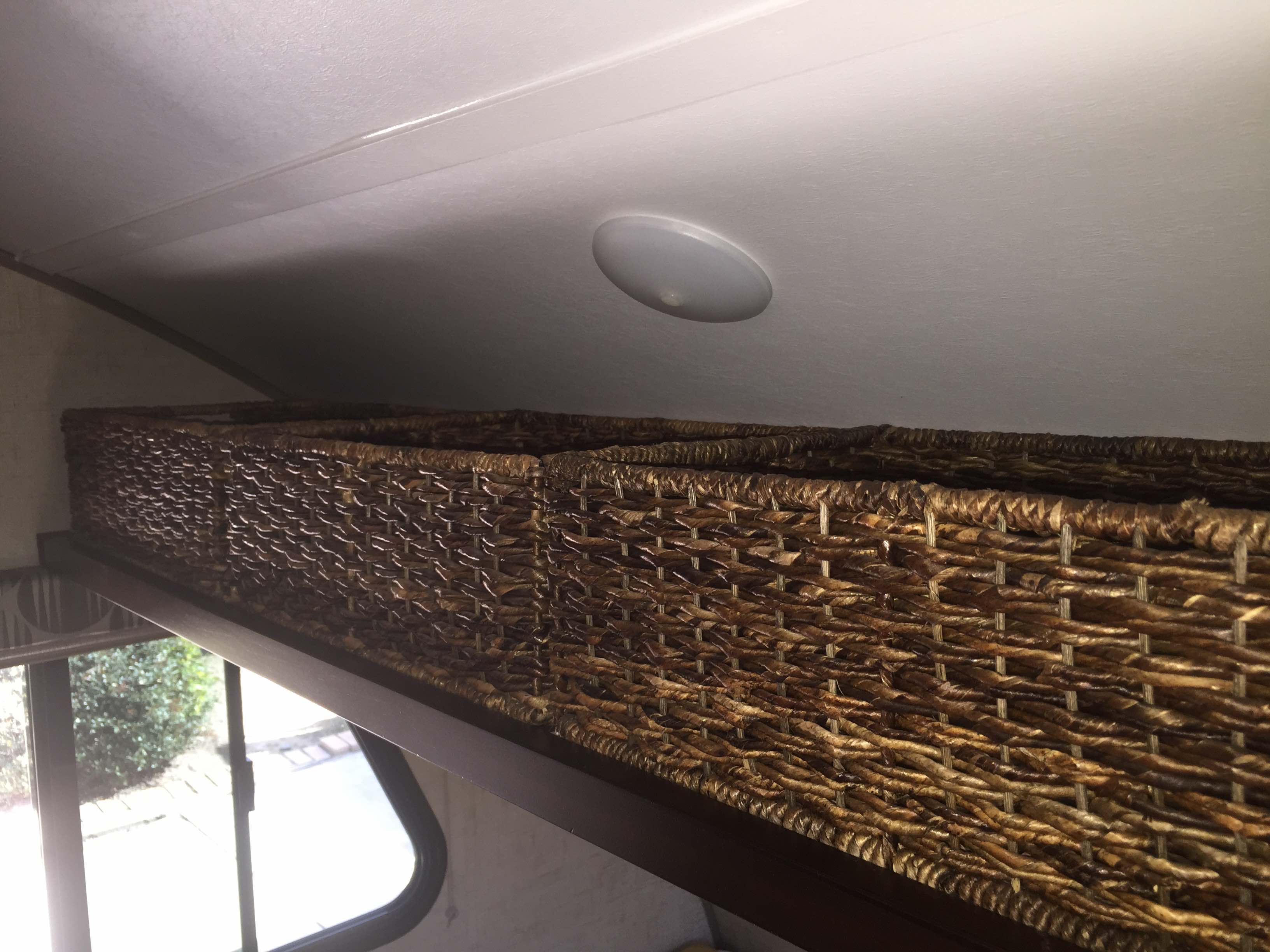

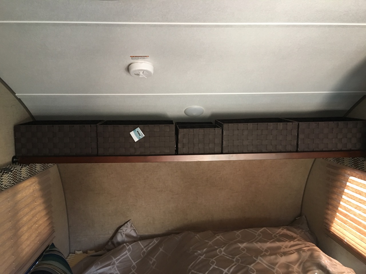

On our last trip we tried out the ole shelf over the bed with baskets mod so many other podders have done. Cost was about $110.00. It offers plenty of room for 4 real nice sized baskets to hold clothes and access is very user friendly. I will say that the mod is probably at least a 5 out of 10 for level of difficulty. Like many others, we found the perfect shelf at Lowes, the finish basically matches the bathroom door perfectly. The baskets were a little harder to find but we got lucky at Michael's with a 50% off sale. WARNING to people who do not normally buy baskets...prepare for sticker shock! Good baskets are expensive! No more digging in duffles for socks for us! YAY!

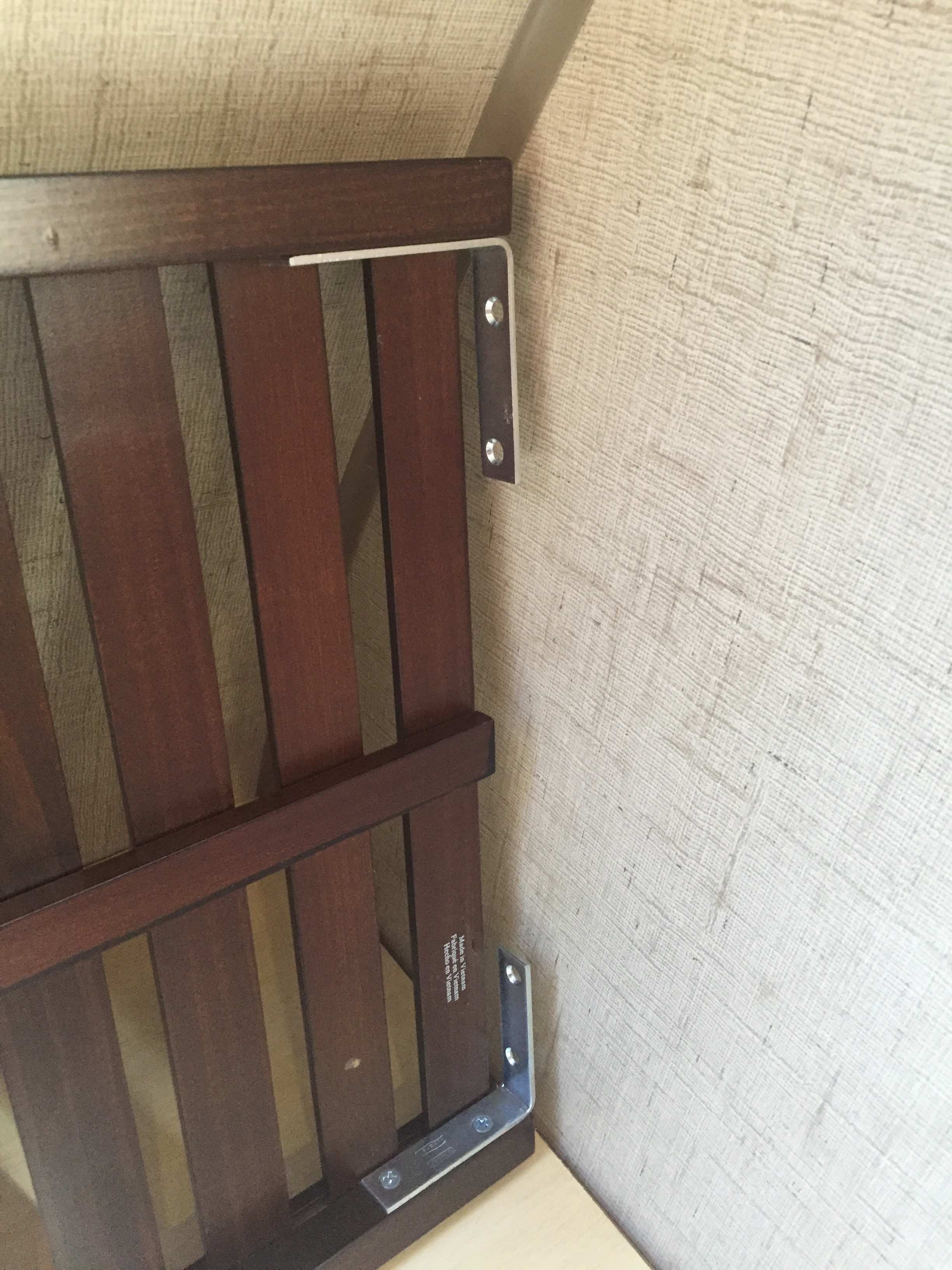

I used 3" L brackets. The shelf is part of a closet storage system, sorry...I don't know the part number. The trick was finding the right location for the shelf vs the type of baskets to be used.

I'm a little concerned that the real wicker might snag my "dainty unmentionables". LOL
Not a problem here, the baskets we purchased are lined on the inside. Smile

The baskets fit perfectly onto the width of the shelf, sitting inside the given channel to keep them from shifting. The shelf has to be forward of the rear roof to allow for clearance of the back of the baskets.
I positioned the shelf just far enough back to allow the baskets to clear the sloping roof. Admittedly, it's light duty but should be fine. If it fails, I will extend the length of the self to the full 74" (well 73.5") and install a rail for it to sit on. We travel with the baskets loaded sitting on the bed and when we camp, we place them on the shelf.
I found the wicker baskets at Lowe's to be very "sheddy" and ruled them out because I didn't want to load the bed with sticky itchy wicker wickets.

I removed the valence and the top of the sliding blind (cornice board?) so I could place front L bracket behind the metal part of the blind, it is also resting on top of the aluminum frame of the window. The metal part of the blind is re-installed over the L bracket. The back L bracket is lower because I wanted to have a slight angle down in back to help keep them in place.
The location is ideal for me because my baskets clear but don't touch the rear roof wall and when standing next to the bed the shelf sits back far enough to not be an issue. Also, no problem getting into our out of bed, even crawling over. Dropping the rear some helped me get the clearance I wanted without having to move the shelf forward.

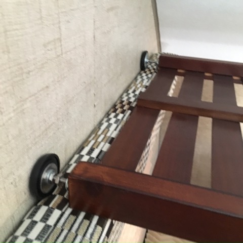

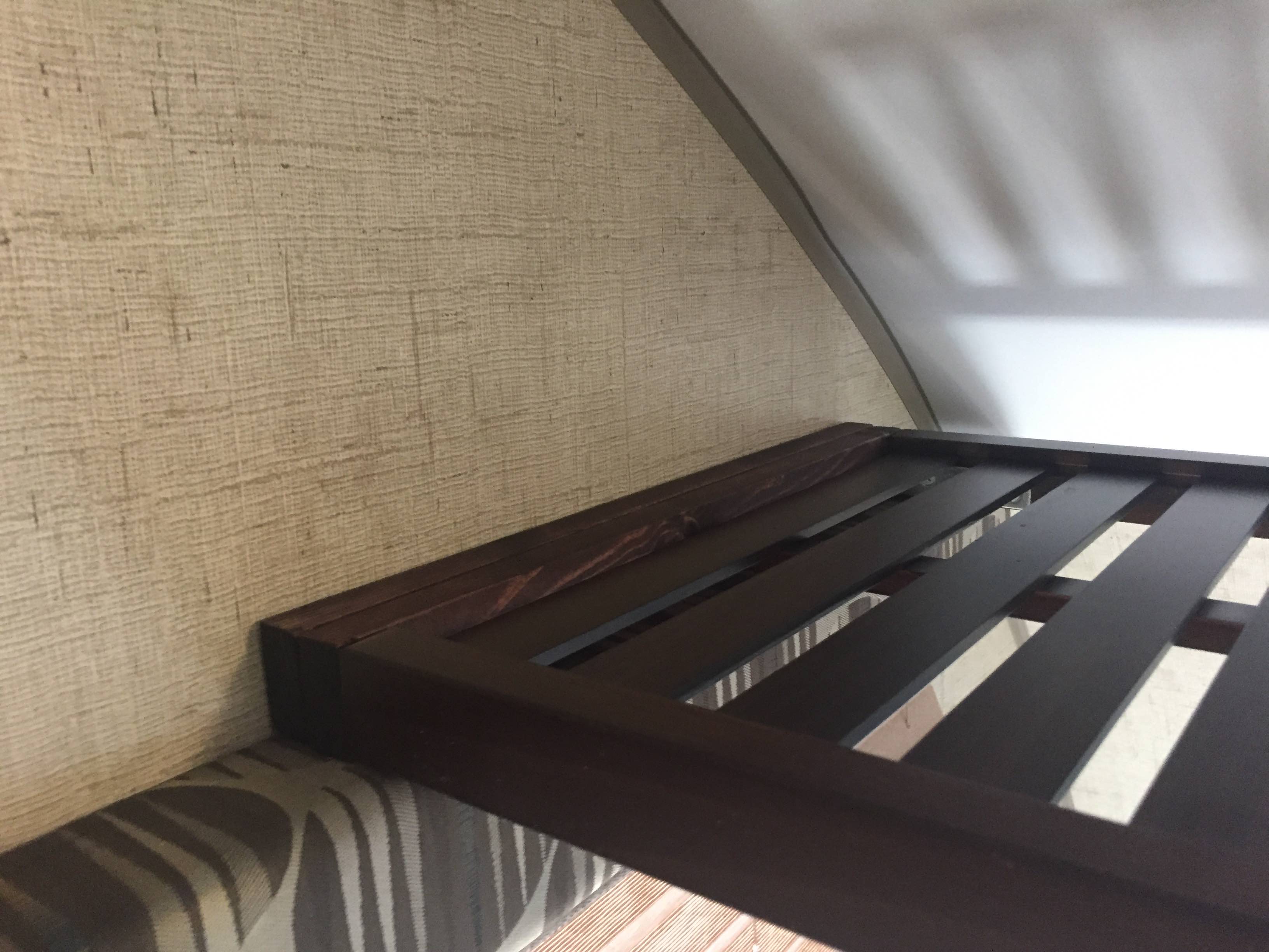

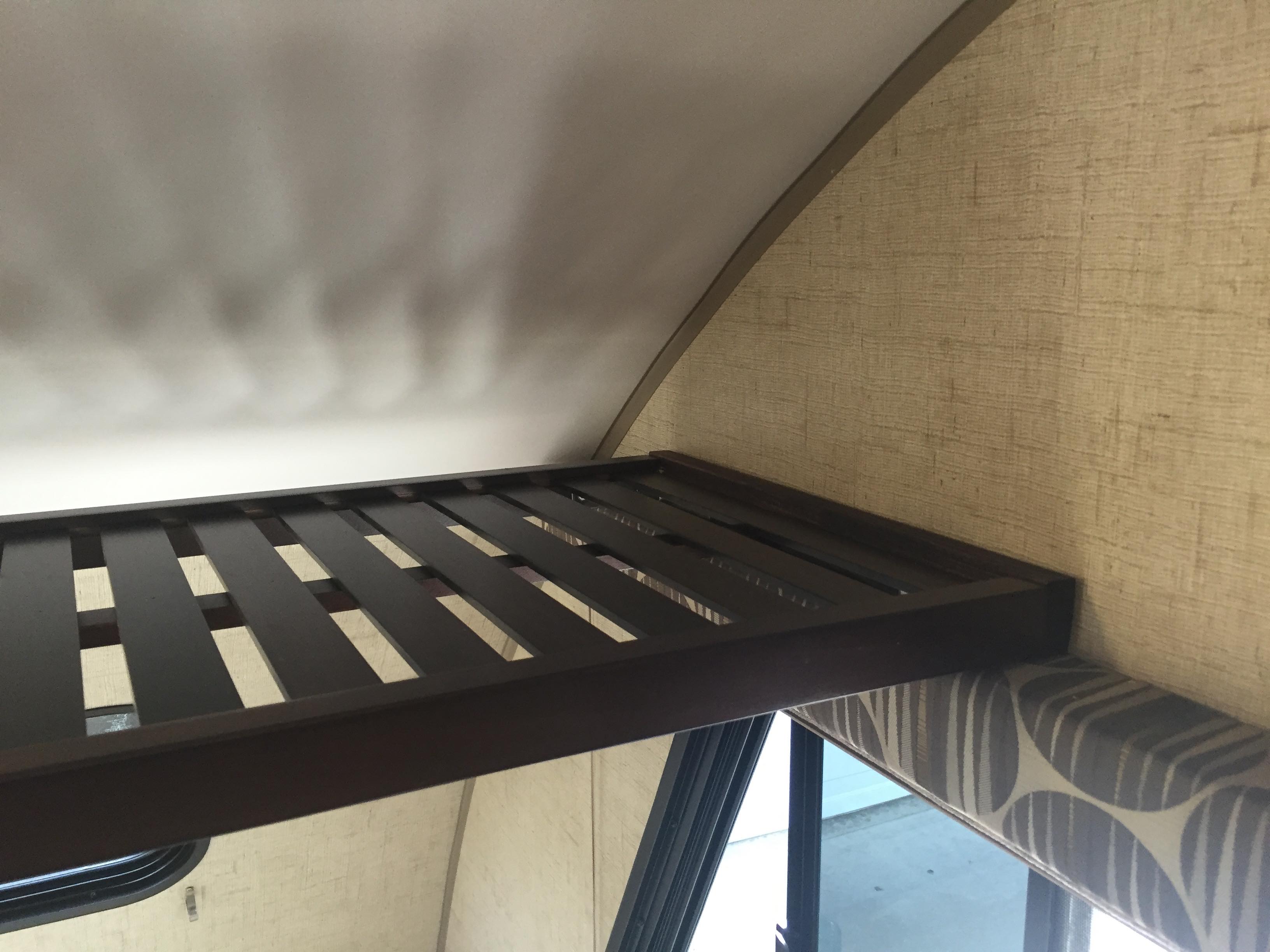

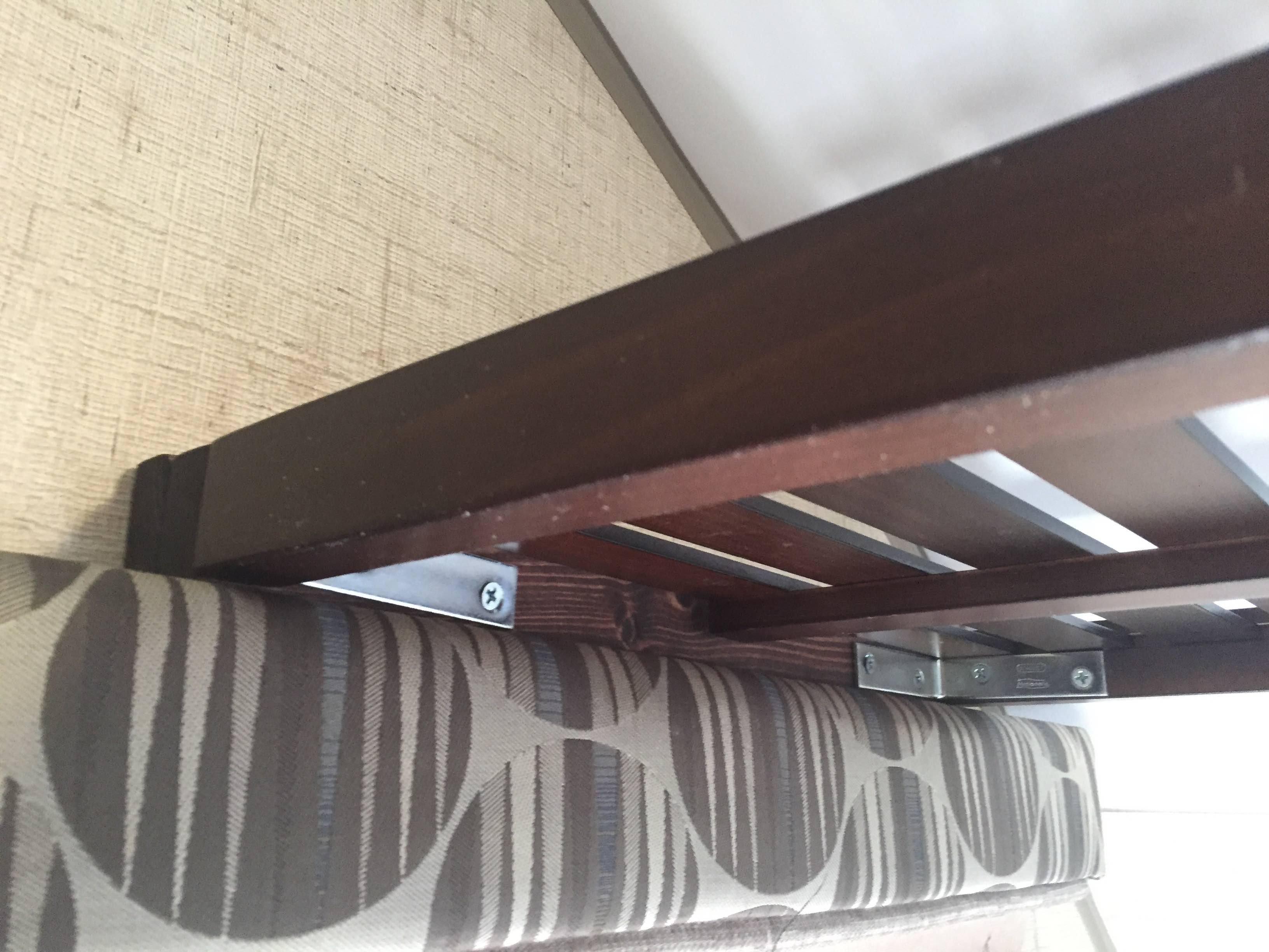

I'm new to this group, new pod owner and loved this idea, but wasn't crazy about putting holes in my brand new 178.  So, I came up with a different approach to mounting a 72" shelf across a ~74 1/4" space.  I used 3M Extreme Mounting Tape - outdoor rated to 80lbs.
First I purchased a 1x2" and cut 3 pieces to the 16" width as the shelf I purchased at Lowes.  The way the math worked for me was I needed 74 1/4"  across the back of the pod and each 1x2 is actually 3/4" inch wide, so three of them = the 2 1/4" I needed + 72" of the shelf = 74 1/4".  Two on one side and one on the other.  Well my pod is just a smidgeon wider and I wanted to keep slight positive pressure on the mounting tape so everything was snug.  So, I cut a paint stirring stick and shimmed the gap.  I tested the fit by laying everything on top of the valences.  Satisfied with the fit, I stained the boards with some left-over stain that was close enough to the color of the shelf, didn't matter to me because I'm color blind Smile, but the wife said "close enough".
I screwed a 1x3 to each side with 3" L brackets - making sure to pre-drill in the shelf so I didn't split the wood.  Then I removed a board from one side, leaving the L bracket ready to remount to that board when I installed it.
I then measure the distance to the back of the pod, so that the baskets fit snug against the front lip of the shelf and stuck the boards (the undrilled one + the one i previously mounted to L bracket) against the wall right over the valences with the two sided mounting tape.
Then I mounted the shelf, with the L bracket to one side, on the other I used 4 1 1/4" dry wall screws to screw the two 1x3 boards together.  Tested everything - put up the 4 perfect sized baskets we found at Target - Sweet!

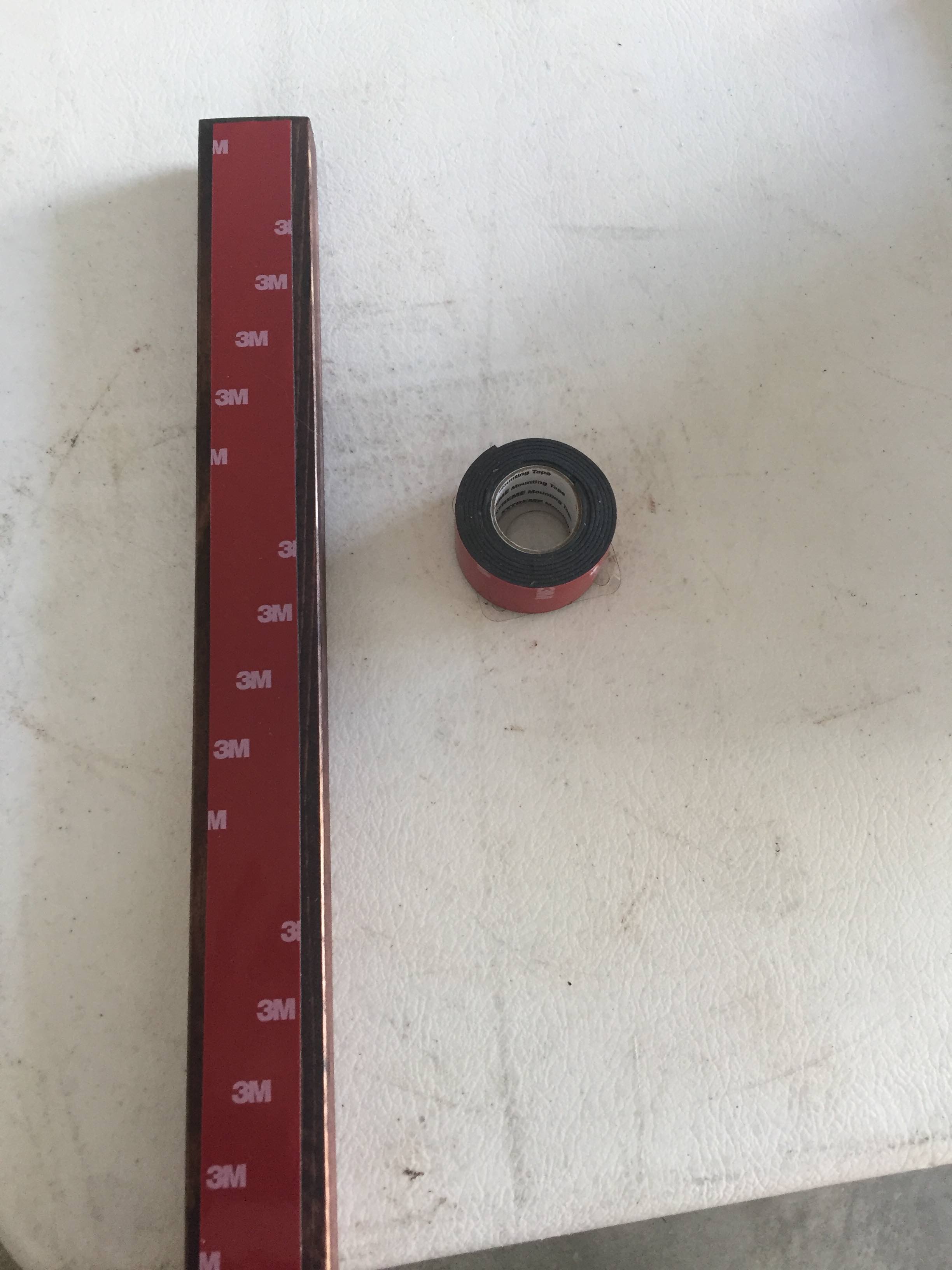

I've used 3M Extreme Mounting Tape in SE Texas (Houston) to mount outdoor lights and worked well there...must be too dry & cool in San Antonio. Wink
I live in Cali now, and just got back from 1st trip with new shelf to Jalama Beach and it worked great, temps 50-75F.  In two weeks I'll be taking the pod for a week of skiing in Mammoth and storing it there for subsequent spring skiing.  We'll see how the tape handles sub-freezing temps, when I store it.
I honestly have not tried it. I like doing things once and I don't see any tape as a permanent mounting solution. Maybe times are changing and this super tape IS the ticket, but I'm not there yet. Smile

I also used 4 strips of 3M Commander Adhesive to mount a full length mirror to the front of the bathroom door and all kinds of hooks picture frames, etc. I have about 4 months and hot and cold trips on it. So far so good. Who knows maybe my world of adhesives will come crashing down around me one day. if so I'll break out the drill and screws

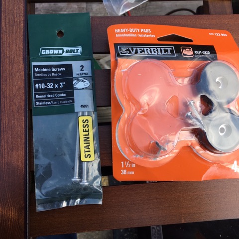

What is screw compression hardware called?  I looked at Home Depot and could not find something similar.
Thanks

I drilled the end of the shelf inserted a "T"-nut insert and then made up tension elements with these.
Posted By: jackwho
Date Posted: 21 Apr 2016 at 1:18pm
Here is a close up.
Posted By: podgirl
Date Posted: 21 Apr 2016 at 2:36pm
Jackwho,
Thank you so much for the supplies with pictures! This seems like the best idea so far.
Thanks again,
Podgirl

Posted By: podgirl
Date Posted: 27 Apr 2016 at 1:19pm
JackWho,
Well forgot to ask what size t nut did you use? Thanks
Podgirl
Sally
Posted By: jackwho
Date Posted: 27 Apr 2016 at 8:30pm
10-32 in a 1/4" hole

Posted By: bigcat
Date Posted: 12 Dec 2016 at 1:16pm
Jackwho, I love this! How do you extend the pads to create a enough tension? Or is the valance bearing the weight?
Big Cat
2017 179
Posted By: Dragon Pilot
Date Posted: 18 Dec 2016 at 11:53am
So... you drilled a 1/4" hole into the shelf end and then inserted the bolt head into the hole... have I got that right? How deep did you drill?
RP-178, 1997 Explorer 5.0 V8 AWD

Posted By: twodues
Date Posted: 01 Mar 2017 at 9:28am
jackwho This method worked great! Movable/removable and no drilling into the pod.

twodues, How do you extend the pads to create a enough tension? Or is the valance bearing the weight?
Big Cat
2017 179
Posted By: twodues
Date Posted: 01 Mar 2017 at 11:45am
The valance bears some weight. The set up for the tensioners is like this: 10-32 bolt thru non-skid pad, 10-32 nut tightened down to hold pad at the end of the bolt. End of shelf rails drilled 1/8 pilot 2 1/2" deep, then larger hole to accommodate the bolt diameter. One last drill out to 5/8" depth to set the 10-32 tee nut in the end of the shelf rail. I also put a second nut on each bolt tightened against the tee nut to prevent the tensioners from turning further into the tee nut.

I'm not a fan of any solution that results in putting any force, at all, against the sidewalls. I mean like zero. Smile

Hi all, just wanted to share my results with the shelf mod. The shower curtain and pads worked great. I didn't crank down the rods so there was a lot of pressure and the shelf held well. The valances don't bear any weight, and are attached with small screws. I took the valances off and set the pads on the top edge of the window frame (not pictured). Very sturdy.

Posted By: Idahojones
Date Posted: 06 Nov 2017 at 5:29pm
Does the shelf and/or the baskets block light from the two ceiling lights over the table?
Idaho Jones
Posted By: bigcat
Date Posted: 06 Nov 2017 at 10:14pm
The shelf is over our bed and it doesn’t block too much light. The shelf is vented which allows for light through the slats.
Big Cat
2017 179

Hello !!!! I am hoping to create this same ventilated shelf of my 171.
The only ventilated wood shelves I can find are 72" but my space is 74.25. Thus, the expanding foot is excellent, however, I can't tell if you have yours on both ends ?
The Second Amendment assures your rights to complain about it.
Posted By: bigcat
Date Posted: 03 Jul 2019 at 10:18am
Yeah, I have them on both ends.

Posted By: Kup-Pod
Date Posted: 03 Jul 2019 at 9:33pm
I found the shelf blocked a fair bit of light from the fixture at night so I just put a metal strip under one of the wooden slats and installed a magnetic battery operated led puck light...works great and the AAA batteries last reasonably long Great for reading at night
2017 RP-178
2021 F150 5.0l
"Lead me on a level path"
Posted By: banjoman15
Date Posted: 04 Jul 2019 at 7:21am
Right! My wife was concerned about that issue, so your idea will be a good solution to that.
