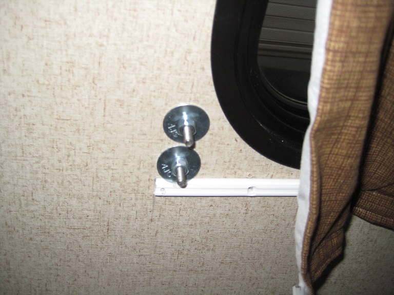

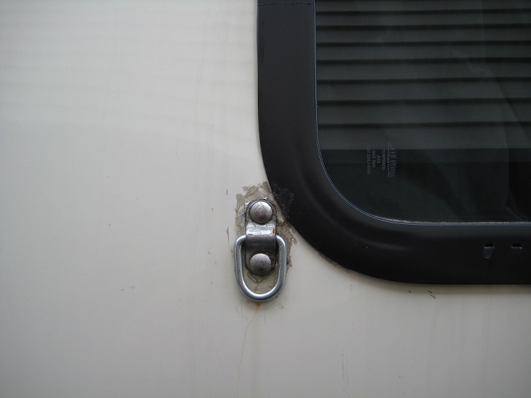

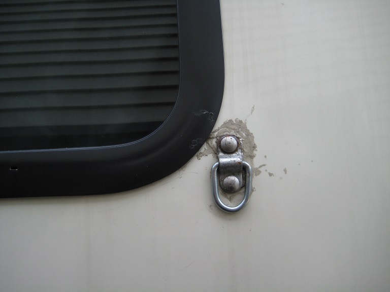

Personally I use a 1up USA with one or two bikes, and I added some D-Ring tie down anchors at each side of the rear window to stabilize the bike rack with straps, and prevent it from bouncing at all. Solid.
Multiple trips and no issues, best part is the rack comes out of the 1-1/4" R-Pod receiver, then coverts to 2 inch receiver and gets put in my SUV.

D-ring tie downs you say? Any pictures?

Outside and Inside pictures . Silicone Caulk to keep water out (rushed the job before a weekend trip, I will clean and re-caulk someday), Carriage bolts through the frame structure, using fender washers to distribute the clamping force. I haven't cut the bolts down yet, since they aren't in my way . Eventually will cut them shorter, and install a nice crown nut.
If I wasn't so lazy, I would install the rack, my bike, and the bungees and straps , maybe next trip I'll remember to take some pics. The bike does NOT bounce. The welds of the receiver are holding up fine, and there are NO cracks in the fiberglass wall structure or water intrusion from the holes are at the windows seal. I have used this setup for 4 trips now.
They came inside very close to the curtain track (didn't expect that) but I take function over form.

I have the same bike rack setup you do and have been using it for 5 seasons now with no straps, and no problems so far. But I have mentioned to SWMBO that I'd like to run some straps back to the pod to keep the bouncing down. I do remember a post years ago where someone's rear mount bike rack failed at the frame on one of their first outings - I think the frame welds were determined to be faulty. I know it made a royal mess of the bikes before they got stopped.
I thought a good move might be to move the bikes to the front of the truck, but after checking out front mount receivers and doing some measuring, it seemed like the bikes would ride too high and obstruct my vision too much without maybe changing to a different bike rack too.
Thanks for the pictures, I think this is a good mod.
