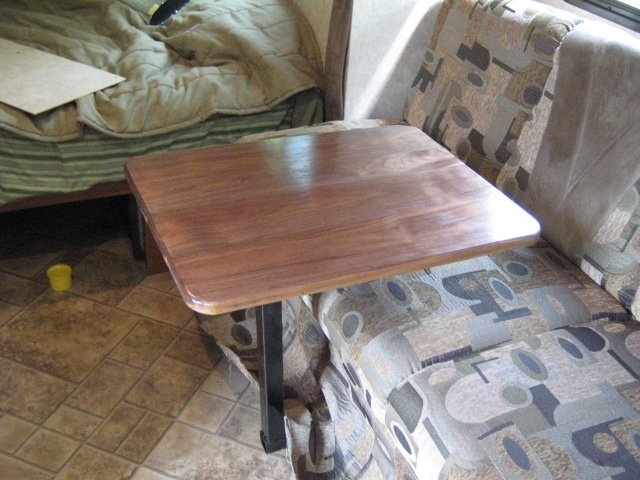

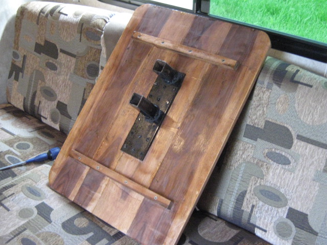

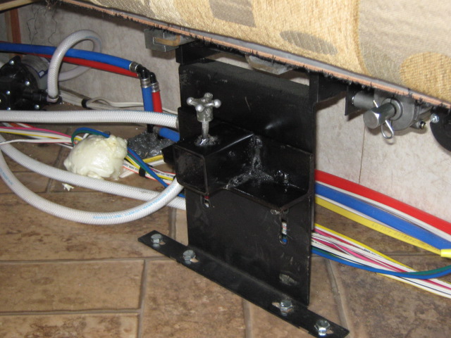

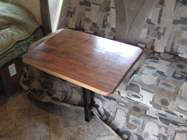

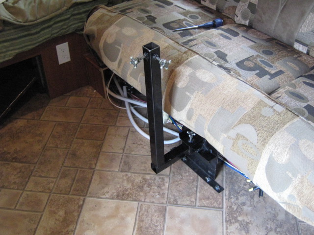

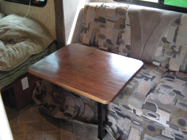

here is the table mod that i have done on our 175. it is 17.5 "x 23.5". it is basically built the same way a reciever hitch is made. the table has 3 positions that it can be postioned . i made it from scrape metal that i had laying around and the top i made from some walnut boards that i had

I like the concept, so you aren't tripping over a floor-mount when the table isn't there. Looks like it is built like a tank!

that's a pretty neat way of doing it.

i had looked at putting a pedastal in but did not want to cut a hole in the floor and had one in a truck slide in and never liked it. the metal tube is 3/16 pretty light . and this is a lot lighter and less bulky than the 4 foot table that came with the camper. i can get in the bathroom with the table up in any position. i know it is pretty much 175 specific though. 2 bolts and i can get take the whole thing out

Nice job! fred
