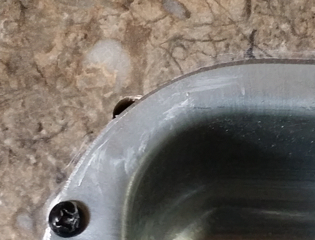

Word to the wise-  pull your stove top off and see if they left unsealed HOLES in the corners of the counter where they mounted the stove.
See pic below.
 Boil something over on the stove, or have a spill and you too can be the proud owner of a swollen countertop.
 I found these and sealed them in the first few days of ownership. In fact I lifted the stove and caulked the entire perimeter, which is the small amount of sealant in the pic, then I went and filled the holes after the pic was taken.  I've had to do this to several RVs in the past.
BTW the damage to the counter that this thread was about was not evident when I sealed the stove top.
My current theory is maybe the faucet assembly was swiveled over out of the sink, the faucet was open, when during PDI,  the dealer attached the hose and turned on the water, thereby flooding the countertop.  It takes awhile for the swelling to set in, hence the reason we didn't detect it until after a week had passed.   And like someone mentioned they did not caulk the edge trim, just the perimeter of the counter....
