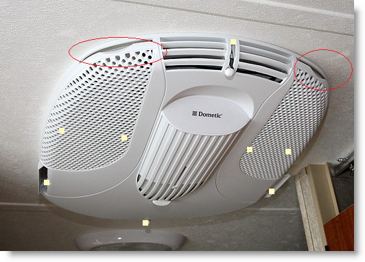

Direct Link To This Post Posted: 16 Oct 2013 at 1:31pm
The red circles are where your filters are, I'm sure they are there you just might not see them.  The middle is just for more air flow.

I shined a flashlight up in the groves where they are suppose to be. I don't see any filters. All I see is wires and tubing.

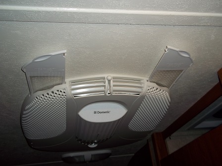

Direct Link To This Post Posted: 17 Oct 2013 at 1:18am
Here you can see where your AC filters are.

Direct Link To This Post Posted: 17 Oct 2013 at 8:41am
Thank you Marwayne. My system does not have those. Where cane I get some?
