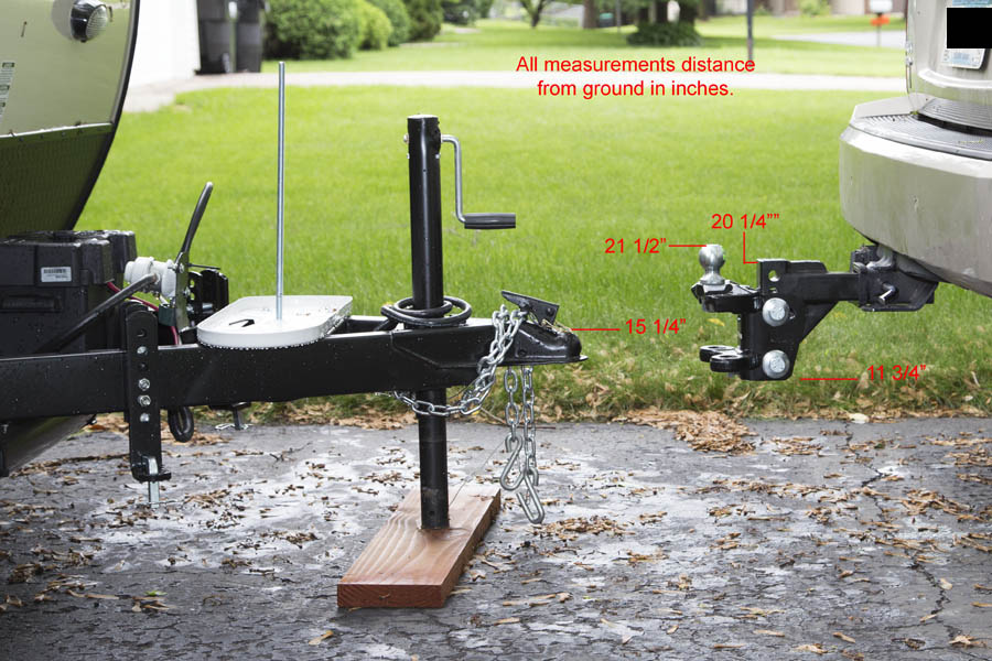

As already mentioned, first get the risers and then go from there.  You'll gain 3 1/2 inches from the risers so you won't need a much larger shank.  Use this online tool to figure out the shank size you need (the Equalizer is the E2's big brother and is made by the same company), just add 3 1/2 inches to the Coupler Height.  Until you get your final configuration, if the 173 has the fresh water tank up front I recommend towing with a full tank to put more load on the tongue (or filling either the gray or black tank if they are up front and you can dump them when you get to camp).

Here is my E2 Hitch on my 09 Jeep Liberty. I have the 2 1/2 inch drop and axle risers. I am still about an inch high but I have not had any issues with this. I would recommend axle risers as they make sense anyways. I scraped both rear jacks off of my Pod before I put the risers on. You will probably have to go to the the 4 inch because It looks like you have a stock hitch which mounts behind the bumper . Mine is a Curt hitch that hangs below the bumper a good 2 inches.
I hope this helps some.

    Welcome to the forum! Our last tow vehicle was a 2010 Liberty and we used the Equalizer 4 point sway control WDH. The Liberty has a high receiver and we too had to order the optional longer shank. I forget the length I will have to measure it not able to do that now. A question do you have the risers on you Rpod? If not I would highly recommend them it will give you more clearance all the way around for your hitch and trailer. Later today I can give you the measurements of our shank. We did get the risers and found out before the risers we did not have enough clearance for the hitch. The Equalizer hitch is a great hitch and helps a lot in towing especially with the Liberty and its short wheel base. Let me know if I can be of any more help.     David

I have been gaining alot of good information from all of you on the forum over the last several months.  I decided on a model 177 and picked it up this week.  I could use some help on my hitch.
Although I can pull the pod with my 2011 Jeep Liberty (with tow kit), with a regular hitch ball, I decided to opt for the Fastway E2 hitch.  After reading different opinions on the forum, I decided it might be good insurance.  When we tried to install it, We found the hitch on the car (at its lowest setting) is about 6 1/4" too high for the trailer (level).

The  picture shows the different measurements.  It seems like I have two options if I hope to get this hitch to work on my Jeep.
Option 1 - The hitch manufacturer makes two additional size of shanks that would give me more drop.  They have one that will give 7" of drop that should do the trick.  The only problem I am concerned with is that it adds about 6" more drop to the shank so that the bottom of that would be about 5 3/4" off the ground.  Will that cause me problems?
Option 2 - They also make a bar with about 4" of drop.  That is 11" in length and would be about 8 3/4" off the ground.  So, I think the second option would be to put a riser kit on the Rpod and get the mid length shank.
I would appreciate any suggestions based on your experiences.  Are there other solutions I haven't thought of?  Thanks in advance for any help.
