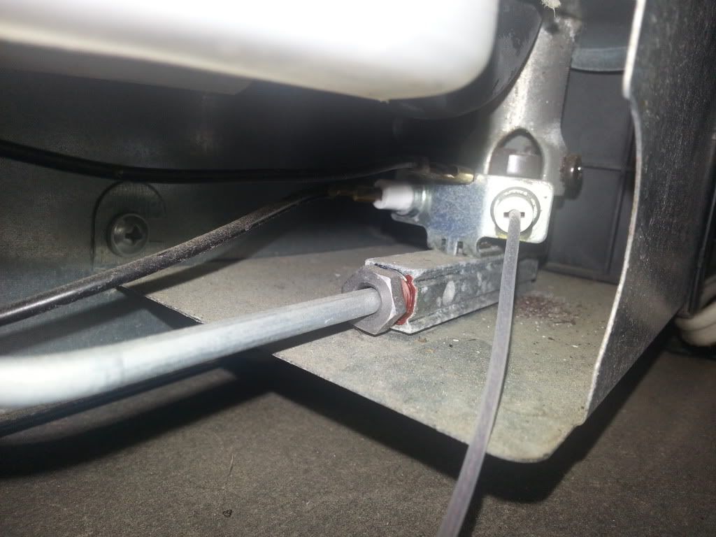

Direct Link To This Post Posted: 08 Jun 2013 at 5:21pm
Hear are the pictures the first is of the of the lower bay of the fridge from outside the square metal area houses the gas burner.
This is a picture inside the burner. Sometimes dust and cobwebs in hear will interfere with the burner just blow it out with compressed air.

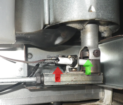

Direct Link To This Post Posted: 08 Jul 2013 at 10:09pm
Sean,  thanks for the photos.
I investigated the flame area and here is what I found, along with a photo to help my description!
When my pilot lights, the flame comes out the front and back holes indicated by the red arrow.  I noticed it had really heated up the wires above the flame.  I'm thinking the two slim white things to the right of the red arrow is the ignitor?  I believe my flame should be where my green arrow is?  If this is the case, I think I have a serious clog and I don't think I'm comfortable dis-assembling the unit any further, and should take it to some one who knows more than I do about cleaning this unit out.  Do you guys agree with my hypothesis?

Direct Link To This Post Posted: 08 Jul 2013 at 10:23pm
I agree that you shouldn't have flame at the red arrow, and need a new starter. Until that is fixed you can still use the AC and DC modes safely.

Direct Link To This Post Posted: 09 Jul 2013 at 8:27am
+1 what techntrek said. looks like you may need a new ignighter. I would leave that to a pro as well. I am usually cautious with gas equipment. I will do minor stuff but leave the major stuff to the pros.
