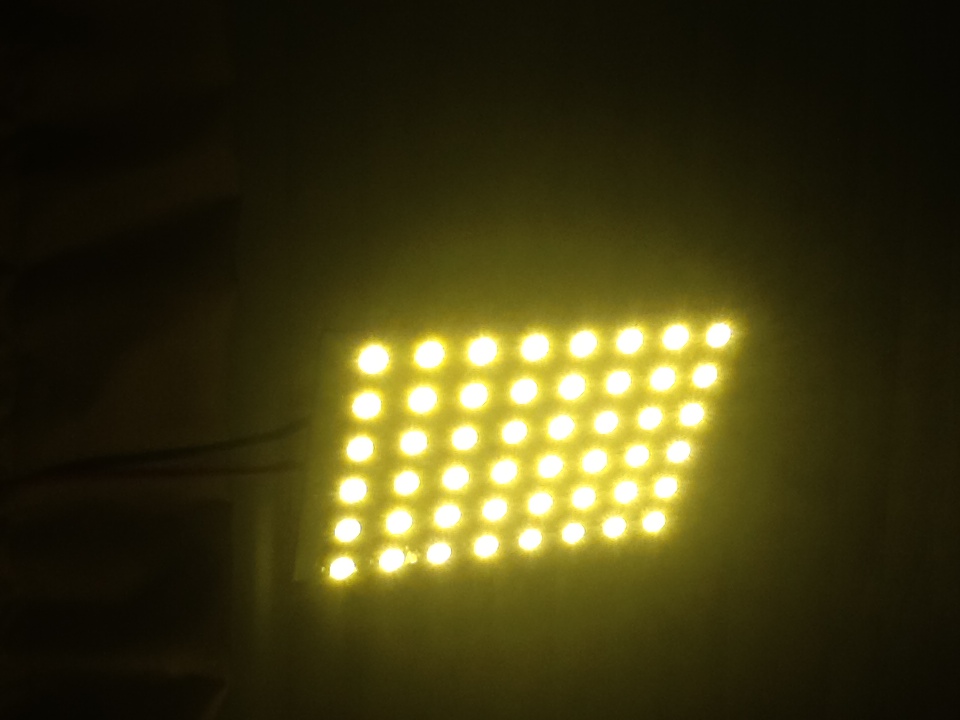

Just got back from my first local trip to Lake Lanier, Ga.  All went well except a springtime mod to my RPod lights.

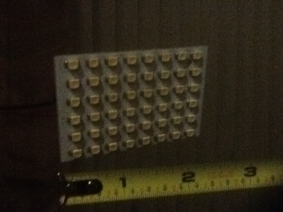

I had purchased a bunch of 6x8 LED panels (less than$30) that came with very small LED's. The supplied two sided tape was used to adhere them in the Rpod fixtures. All looked well. Nice and bright, warm color.
We left them ON at the sink/stove fixture unintentionally when we went on an afternoon trip.  When I got back, it looked like  the panels had become loose and hanging in the fixture . On taking off the lenses, I noticed the LED backing tape had MELTED (it was a soft goo) and the back of the LED's hanging from their wires were TOO HOT TO TOUCH.
Has anyone experienced this? Did I get the wrong LED's? Is there a high temp rated 2-sided tape available?

Bill, I did not know that the LED's got warm or even hot, I always thought that they ran cool. With the wires getting hot makes you wonder if they are undersized for the load. It is something to worry about as it could be a fire hazard, good thing you got back when you did. Goose

Goose,  it wasn't the wires that were hot, it was the back of the board.   The front of the LED's were not that hot. I wonder if I got some engineering / design rejects?  Made in China.
Anyone know of a reliable source to get replacements that are market tested and reasonably priced?

Goose, even LEDs produce heat, and unlike in incandescent lights the waste heat is a big LED killer.  If you ever buy a LED light for your house (to replace a standard light bulb) you'll see they come with big heat sinks to keep them cool.
