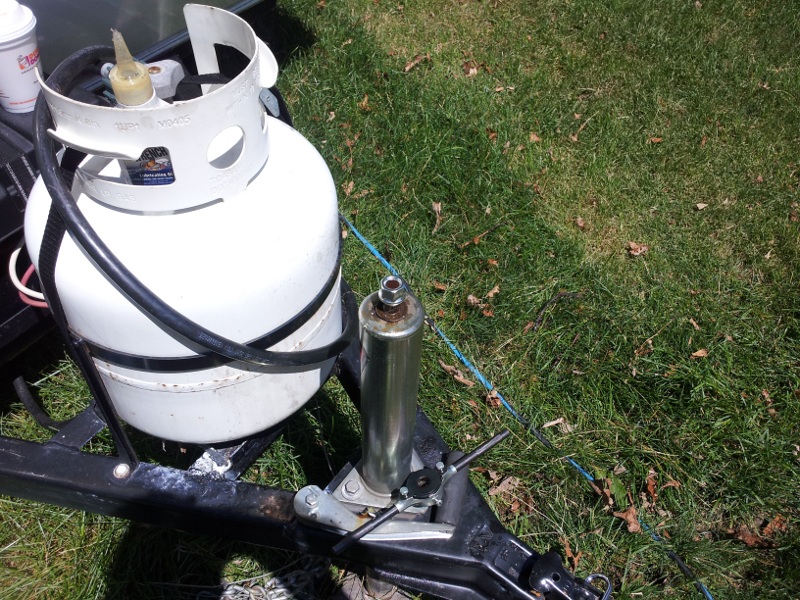

I'll be the first to admit that this is ugly, but it's functional.  I replaced the stock jack with one of those jacks that have the handle on top.  I removed the handle and used a Tap to thread the stud to 1/2", same as a car wheel lug I had laying around.  I put the lug on tight with some loc-tite and now I use the same 3/4" socket on a Ryobi 18V driver that I use for the stabilizers.  Works really well.  It's super fast to slam this on the truck.  No more hand cranking, and not much added expense (esp because I took the jack from another trailer I have).

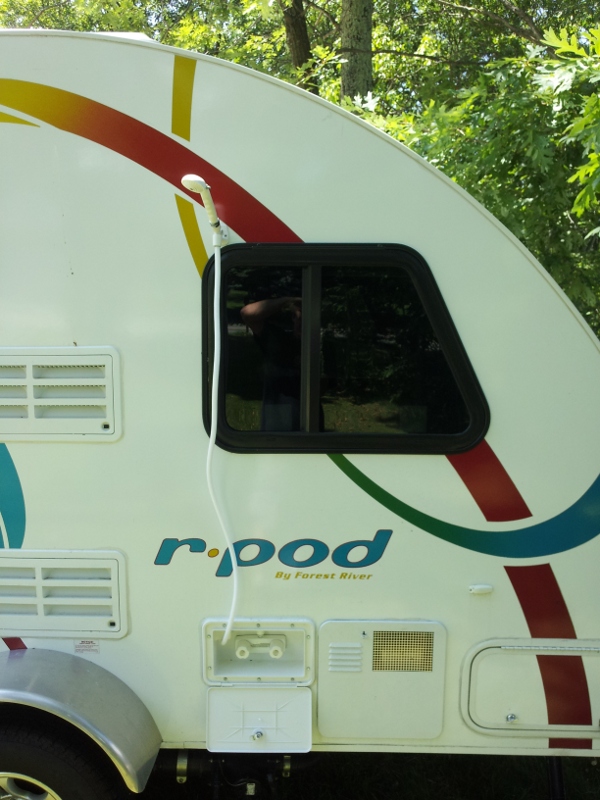

Can't live without this.  It's a pain to walk in to wash hands or clean the grill.

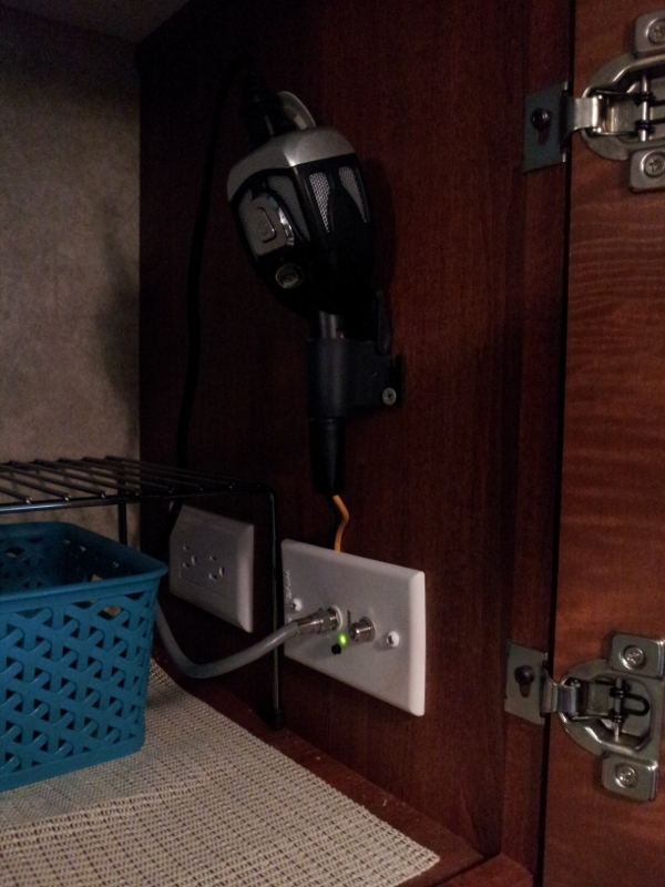

I added this 12V outlet to plug in this small 100W inverter to power the strangely 120VAC TV/DVD combo.  I only use this when on Battery.

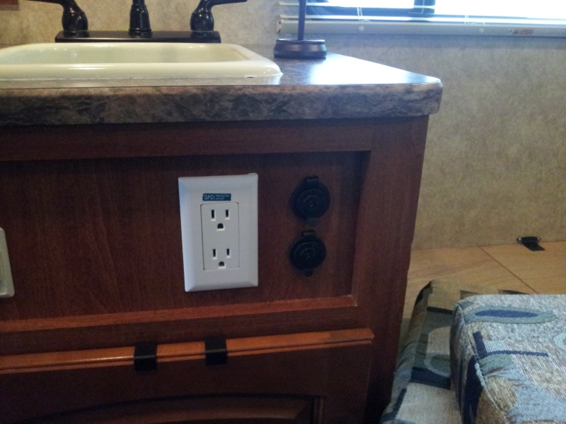

12V outlets - mostly for charging cell phones.

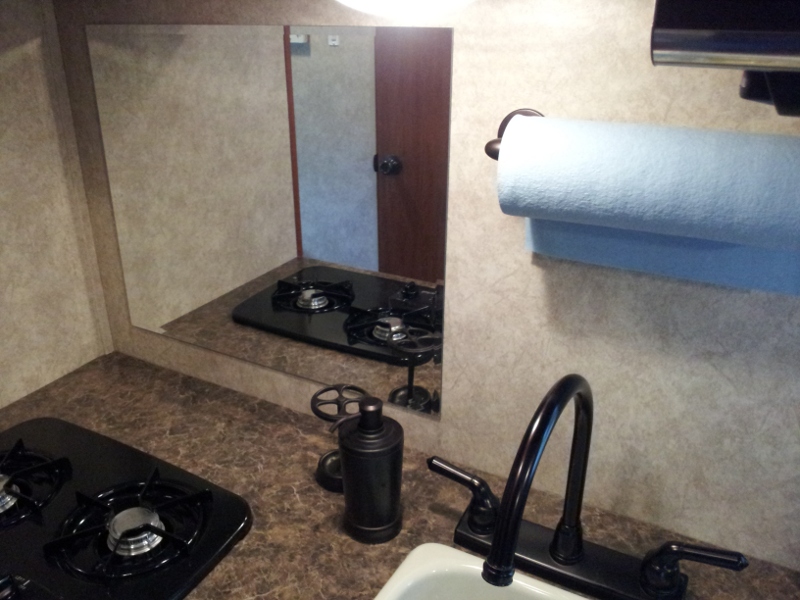

Kitchen - added a mirror from lowes, just to extend the space a bit and a paper towel holder.  I also put the same mirror on the door of the bathroom.

Love how the mirror visually extends the space

+1 on the mirror.
I added an outside shower, too, and your location was my 2nd choice due to wall space and hot/cold water availability in that compartments.  I ended up choosing the area behind the sink because I didn't want to be standing next to the water heater when it fired up because I was using hot water.  Still an issue with the area I chose because the heater exhaust is right there - but we rarely use it so its less of a problem.
You'll find that a 12 volt TV/DVD system is listed in the Wishlist section.  Smile  Why that specific appliance is 120 volts is beyond me, there is no reason for that (other than it was the cheapest bid on the RFQ at the factory).

What's wrong with a little heat exhaust while showering?  People pay good money for that kind of thing.   I chose the spot I did, because it was easy to pull off the cable cover and poke around to find the 'studs', of course it's obvious that hot and cold water was right there as well.
  As for the TV/DVD/Radio, I'm sure it does run on DC internally, it probably wouldn't be a big deal to pull the cover off of it and figure out how to run it on DC.  Might require a small DC/DC converter, but that could probably fit inside the case.   I also installed a 15" 12V DC over the queen bed.

The heat might be fine while showering, but the CO and CO2, not so much.
