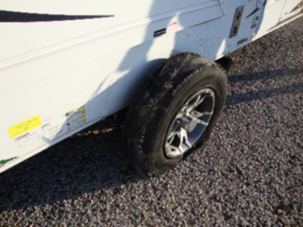

- CryThe worst was on the way home the driver side tire shredded and took out the fender cover, city water connection cover, furnace cover and tore out the electric brakes.  This was our first trip and the tires were supposedly new.  We purchased a new set of tires the next morning as we did not have confidence in the remaining original tire.
This was enough for Robert to say we were going to sell Podder once repairs are made.  He has now calmed down and is willing to give her another try.  It's disappointing to have so many issues with a new trailer.  We pulled a 26 foot fifth wheel for 12 years and never had a problem. Guess we were spoiled.

Sorry to hear you had so many problems.  The A/C is definitely a warranty issue, as well as the water leak (many of us have found loose connections on the drain pipes) and the drawer.  You may even get your dealer to contact FR to see if they'll cover the cost of your new tires and the exterior repairs under warranty - certainly new tires should never shred.  You may not have much leverage if you don't have the shredded tire anymore.

I use to work as an insurance adjuster so  I knew to take pictures and keep both tires. I am hoping Forest River will help us out.  We have insurance, but it would be nice if they would step up and take care of the deductible.

Did you inflate the trailer tire to the max pressure shown on the sidewall? You need to check that and the lug nut torque before each trip. Over time the torque will stabilize but the tire pressure is critical each time. Partly to combat sway, partly so they dont disintegrate. Your TVs tire pressure should also be near max for towing, not what the door sill sticker says. I recommend a few PSIs below max for ride comfort.
