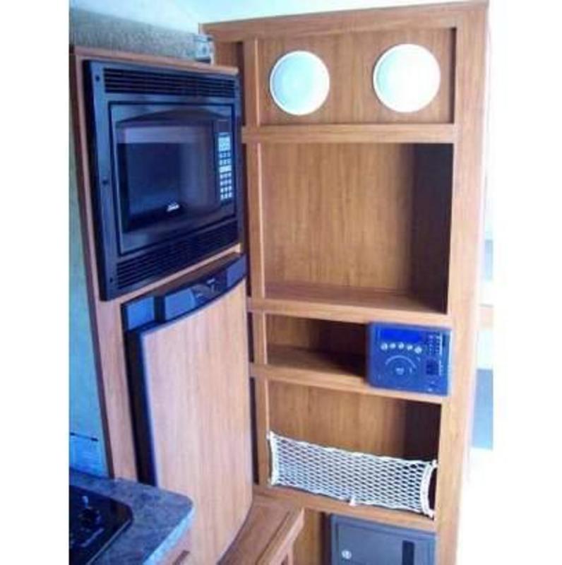

Mine came with a 19" tv but i cant get the dvd player out to get video from the dvd player to the tv
Brigs
Newbie Joined: 10 Jul 2012 Location: Alberta Online Status: Offline Posts: 20 |
Posted: 10 Jul 2012 at 12:56pm |
this is what the seperate dvd system looks like |

I have the 176T.... It was not intuitive, but here is how it works.
The main thing to know is that the sound comes through the wall speakers (not the TV)
The yellow RCA cable plugs into the back of the TV (video 1, yellow) from the single wall RCA outlet.
The red and white RCA cables are not used.
Then select source of Video 1 on the TV.
Let me know if that is not clear.
