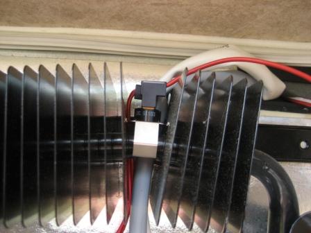

Never got around to doing this last season but am thinking of doing it today. But I need help cause I'm not exactly sure of what I'm doing. In the pic below is what to my knowledge is the t-stat switch which decides when and if to turn on the 2 computer fans below the fins of my fridge to help cool the coils. I want mine to run all the time. I'm probably wrong in assuming it's this easy but can I just pull the wires from the t-stat switch and then stick the 3 fan wires together thus bypassing the t-stat and having the fans run all the time. Seems the likely fix to me. Right? That switch is what triggers and then completes the circuit and allows the fans to come on, so removing them from the t-stat and wiring them together then equals fans on all the time? It's likely I'm missing something or completely out of left field with this idea, so any help is appreciated!

Okay answering my own question here in case anyone in the future wants to do this. If you have the RM8501 Dometic and it's not cooling to your expectations you're in luck because you already have 2 12v CPU fans in the back. Hooray! The little T-stat module there on your cooling fins is easily just disconnected and then as I had thought just connect the two sets of wires that were previously connected to that switch and voila you have permanent cooling fans. I'll likely head to Radio Shack or something tonight and buy a switch so that they aren't running full time in between trips but I'm happy with them being on and there is a nice drop in my fridge temp already. I've even frozen a bottle of water! Also doesn't hurt to have a multimeter probe to get more accurate temps, the little fridge thermometer I bought at Wally world was insanely inaccurate. A quick question though, does anyone ever remove their top fridge cover while they are camping? I noticed a pretty rapid near 2 degree drop in temps just by popping the cover off and laying it next to the Pod.
