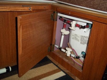

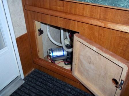

Diane: The answer to your problem is access doors.
Access to pump
Access to hotwatertank
Access to storage
Access to storage and build in cooler from above.

Yeah, you're right - and I could have accessed the pump if I had unscrewed the wall panel.  But as for the hot water tank in the 177, the hot water tank is UNDER the bed, unfortunately.  There's a panel in the basement storage to the hot water tank, but I'm not sure I could have reached my arms in far enough to turn the valves.  I love your built in cooler and your access doors - very clever.  Thanks marwayne!
