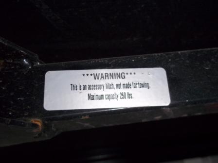

I think the weight limit on the pod's rear receiver is 150 pounds. Do some poking around in the forums. It's not really all that robust.
Posts: 1003
Direct Link To This Post Posted: 07 Nov 2011 at 12:46pm
 max weight for rear receiver is 250#
Direct Link To This Post Posted: 07 Nov 2011 at 1:06pm
When it comes to balancing the trailer as a whole, moving the tire to the tonge will help, but putting a lot of weight on the rear - offset by loads up front or not - can induce sway problems.  The problem of a long lever, where the lever is the pod's frame plus the length of whatever you put on the back.  A small addition of weight on a long lever can make a big difference.
Double-check the welds on the rear receiver, some people have had weld failures.

HuronSailor View Drop Down
Joined: 10 Jun 2009
Location: Owosso MI
Posts: 704
Direct Link To This Post Posted: 07 Nov 2011 at 2:06pm
There we go. I knew there was a picture somewhere.
