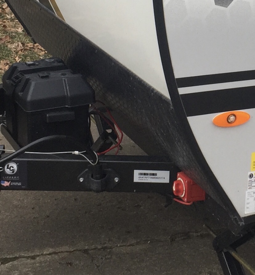

Bowcat66
Newbie Joined: 25 May 2023 Location: Texas Online Status: Offline Posts: 16 |
Post Options Quote Reply Posted: 25 May 2023 at 8:49pm |
Where is the battery cut off located??
God Bless America! Go NAVY!!
Rpod-Couple
Newbie Joined: 21 Jun 2021 Online Status: Offline Posts: 37 |
Post Options Quote Reply Posted: 25 May 2023 at 9:35pm |
It’s a large red switch located near the battery at the front driver side of newer R-Pods. Older R-Pods do not have a switch.
