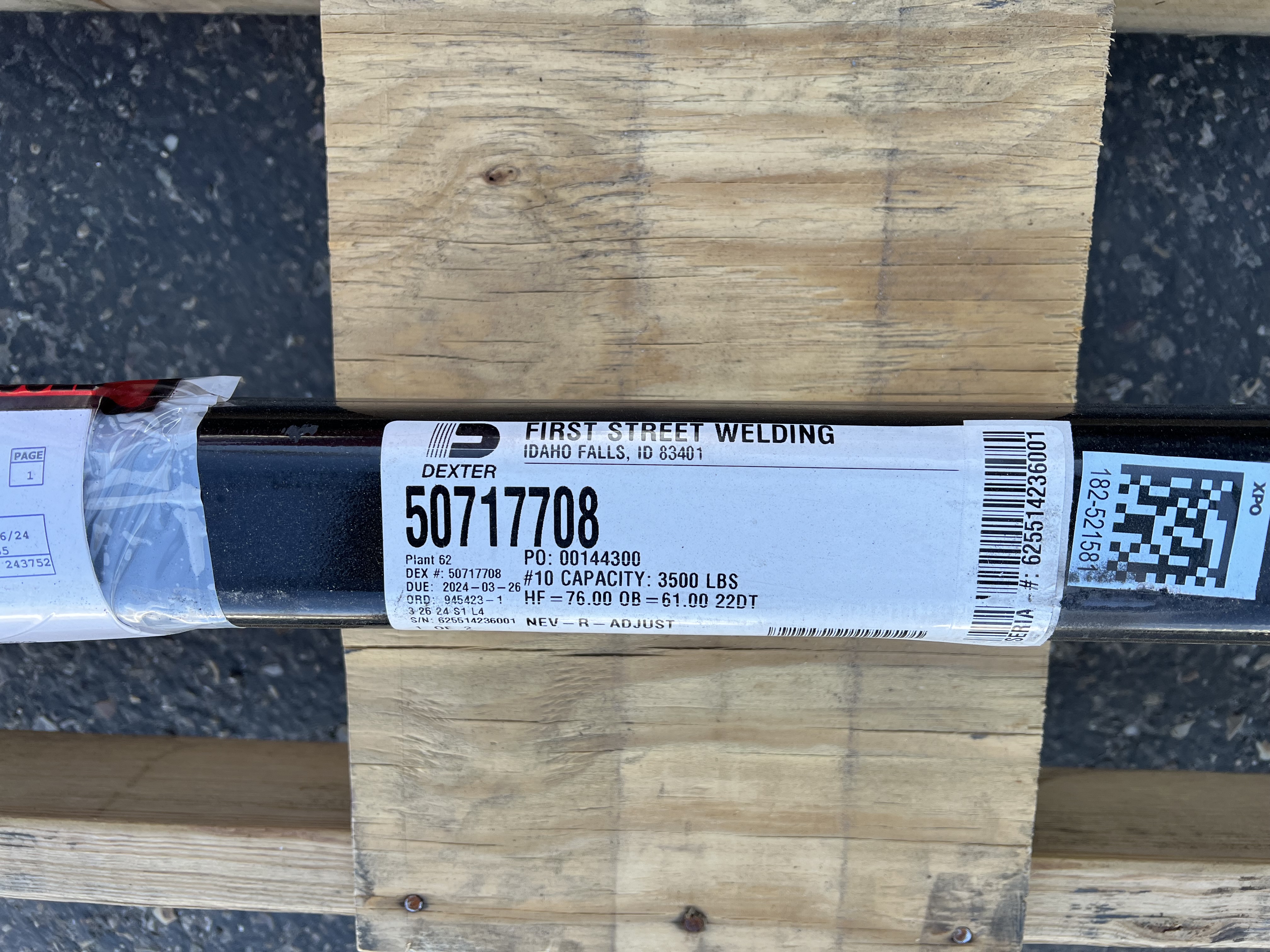

Post Options Post Options   Quote gpokluda Quote  Post ReplyReply Direct Link To This Post Posted: 22 Jul 2024 at 3:14pm
Originally posted by gerry demers
Hi! do you know if those seal (333960) will fit for a R pod 2024 with the coil spring suspension?
If it has not worn off yet, there should be an axle manufacturer sticker on the axle. That will help you find out which bearings and seals you need. Should look something like this. Note that sticker is from the axle on my trailer and not an Rpod.
