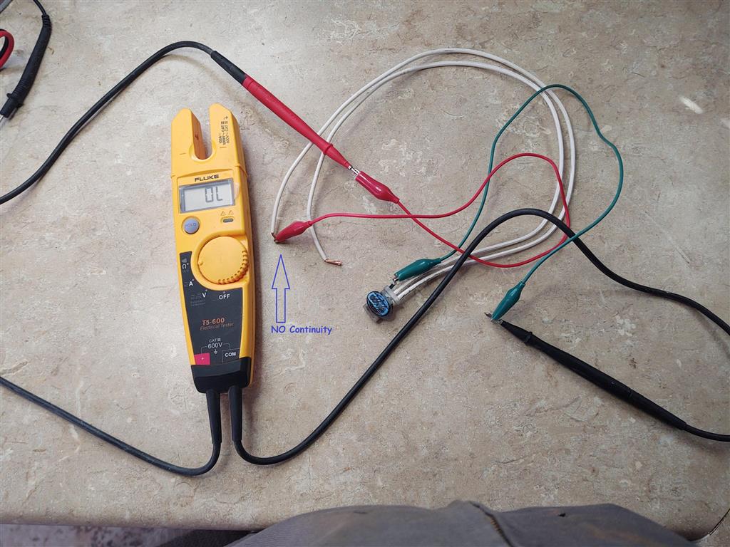

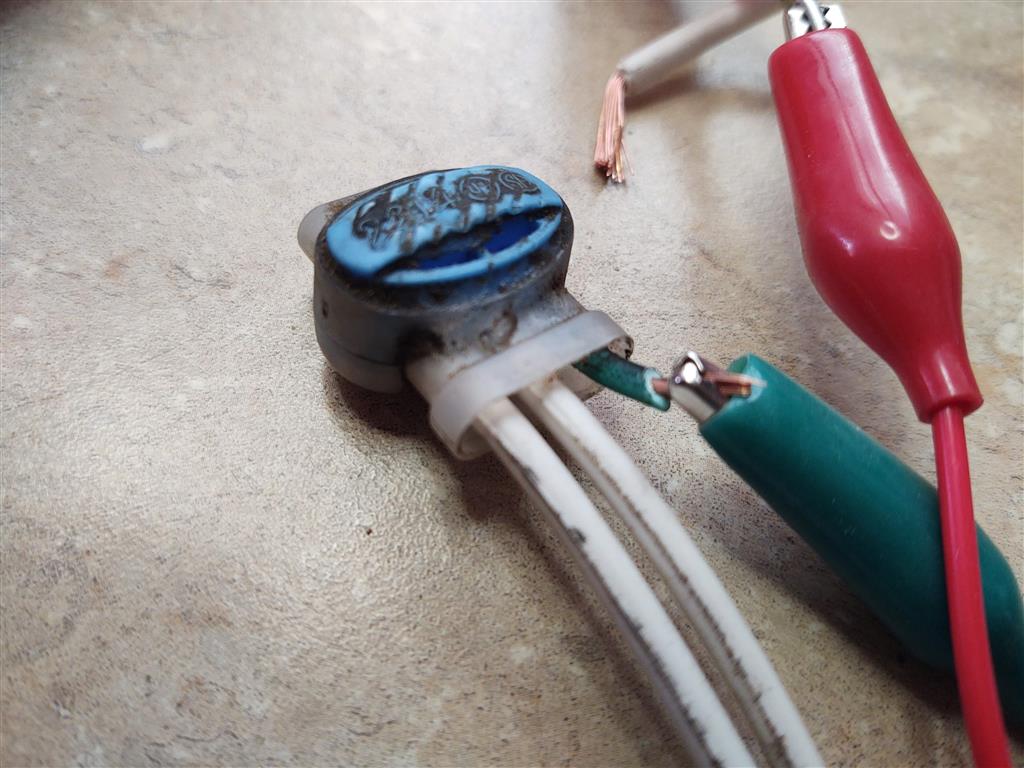

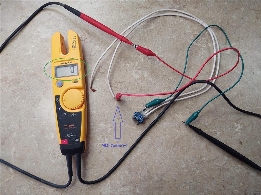

Well not really...but on my last trip I had one side working...but not the other side.
Of course not much I could do on the road but take it easy, and reduce the gain on the brake controller. It was only a 3 day trip and mostly highway use, not intercity panic stops... Anyway, fast forward to this: When I returned home, I began the frustrating process of trying to figure out what was wrong. Those POS 'scotchblocks' caused me a half day of trouble-shooting and then two more half-days of stripping out the old and putting in the new. I stripped out all the old POS brake wiring and re-installed some good stuff, and I soldered EVERYTHING. Both brakes work fine now...after two days of crawling around on the ground underneath the r-pod up on jackstands. The problem turned out to be this one in particular, hanging off the left side brake, and here is what I found: Even though it looks good, there is continuity from the green wire to ONE of the other wires, but not the other wire. This is the 'ground' pair, where it splits off from the left side electric brake, feeding the right side electric brake. So if you end up with the left brake heating up and the right side still cold....suspect the 'scotchblocks'! ![]() ![]() ![]() |
