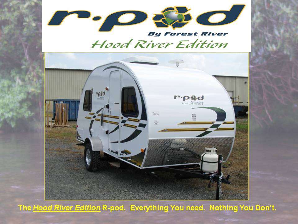

Doesn't that brochure seem a bit amateurish? 'Specially compared to Forest River's 2010 r-pod brochure. On this brochure, there isn't much information on each page; the text must be huge in the printed version. I also find it strange that a brochure would feature a picture of a scissor jack. Not to mention that the spoiler and scissor jacks were two things I'd questioned in my previous post; its a bit coincidental that pictures of both appear here.
Speaking of scissor jacks, look at the way that thing hangs down. You'd catch that thing on a rock and rip it off 20 feet after you left the paved road.
Have a look at that tire in the wheel well. It doesn't fit the space properly. There's only 2-3" of clearance at the edges before the tire will start chewing away at the fender. Get that trailer into an off camber situation and the torsion axle will easily go 5-6". I also question how shiny the diamond plate is. You can see a reflection of the tongue and the propane tank. Has anyone ever encountered diamond plate that reflects like a mirror? But strangest yet, this brochure is clearly aimed at customers who already own r-pods. There's no mention of the existing features and options. I'd expect some mention of the wet bath. How about a reference to the large fresh/grey/black tank sizes? The brochure mentions a "digital thermostat," but there's no mention that the trailer has a furnace or an air conditioner - what the heck is the thermostat for? Does the trailer have a fridge? A stove? Water heater? How many people does it sleep? How could anyone expect to attract new customers with this brochure? There simply isn't enough information. Instead, what we're seeing is someone's wish list. Its what they'd like to see (or like to do) to their current r-pod. We're just getting a wind-up. Shenanigans.

It could be that Forest River has not yet made the final brocure. It took them a while before they added the T modesl in. Also looking at the pictures on the side view they show the heater vents and also the door for the Hot Water Heater and fridge. Also the top of the camper has an air condtioning cover on it. I also feel the jacks could easily get caught but also look closely at the drains as they hang low also. I think it is a start. |

Fenders appear to be standard Pod fenders and don't fit the higher profile tires. They don't cover enough of the wheel to be legal, in some states. Making 2 different fenders - not cost effective.
Scissor jacks don' make sense. I seem to recall that they did not recommend jacking the Pod on the frame or axle. (stabilizers only) Real ground clearance is only increased by the additional diameter of the tire. You can raise the Pod 4 feet, if you want, but there is still that pesky axle down there hitting things.
