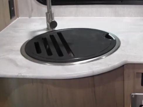

Interesting.  Our 195 has this sink:
Your sink?  (From older 195 walk-through video)

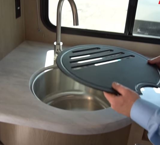

Our sink is the undercounter large round sink in the second image.
JPEG Pod View Drop Down
Joined: 16 May 2020
Posts: 9
Direct Link To This Post Posted: 04 Aug 2020 at 9:37am
So obviously, the dealer should be able to replace ours with this top mount edition!

Thanks but ours is the undercounter round model posted by another member. I appreciate your response though!

It might be possible for the dealer to install the newer top-mount round sink shown in the first image, but I think the dealer would just reinstall the undermount sink and call it a day. There should be sealant around the lip of the undermount sink, both to keep moisture out and to help it to stay in place. If there is none, I would recommend something like Lexel which is water resistant (not for use in prolonged submersion though). Since that seam is unlikely to have prolonged submersion, it should work quite well. Unlike silicone, it is paintable.
