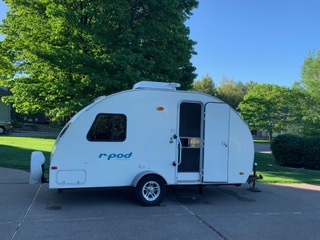

I picked up a 2009 R pod 172 and in the process of de-winterizing.
So when I hook up the city water everything works great, but when I try to use the fresh water, all I get is the faucet trying to spit water out with no luck.   I took the cap of the faucet & located the hot water bypass valves and turned all of them.   Still nothing.
The hot water heater bypass valves are below the dinette, it has three, one red & two blue.
Any advice would be appreciated.   I also would like to take out the bunk beds and make it into a small living room with a chair & tv .   Anyone ever do that and would it affect the integrity of the structure by doing so?
