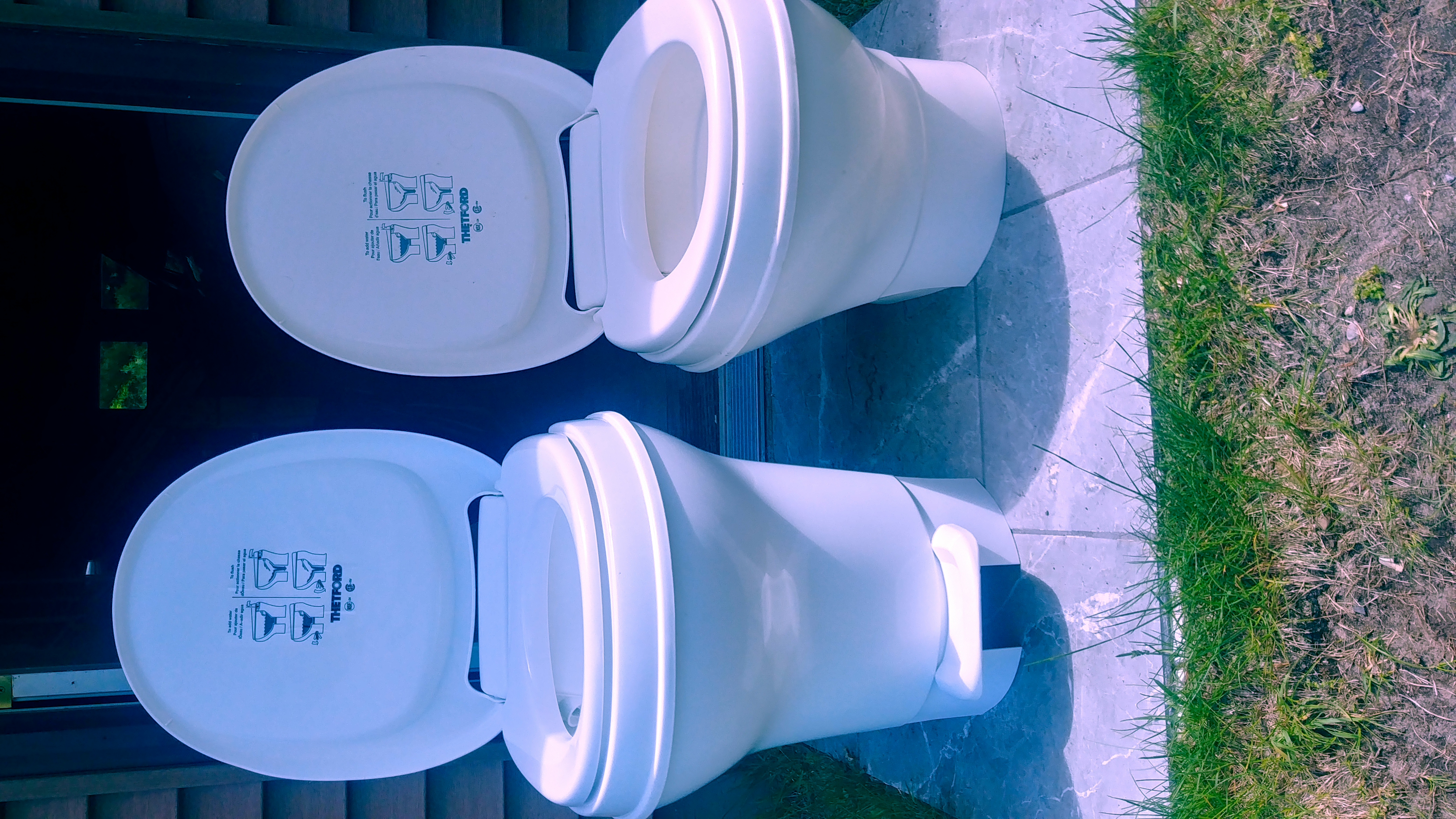

Sorry about the picture, cannot get it to sit upright.  Anyway it was time to replace our 9 year old toilet in the 177.  Still worked fine, but my wife has a knee that doesn't so . . . Amazon to the rescue.  Old toilet floor to seat height was 12.5", new toilet, also made by Thetford, floor to seat height is 17" !!  Much, much better.  Easy job, but you do need to add an additional 4.5" of pex plumbing to the supply line so that it will function.  Thank you Tars Tarkas for the suggestion to use Sharkbite couplings, they are amazing.  Total time to change out, 1 hour.
