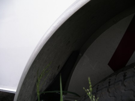

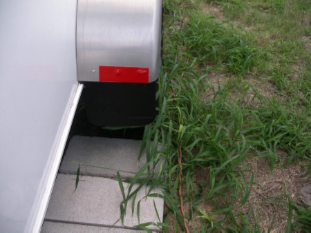

I found a pair of (what I would call ) medium rubber wieght mudd flaps at o reilly's auto.  They are for car or small truck. Just did it last night to late for pictures.
Drilled three wholes, used small screws with lock washers, put the tall part the the flap along the inside of the fender.  Did have to cut out a little piece for the rail (for the r-dome skirt) on the passenger side.

Direct Link To This Post Posted: 09 Jun 2010 at 10:29pm
Here are the pictures as promised.
