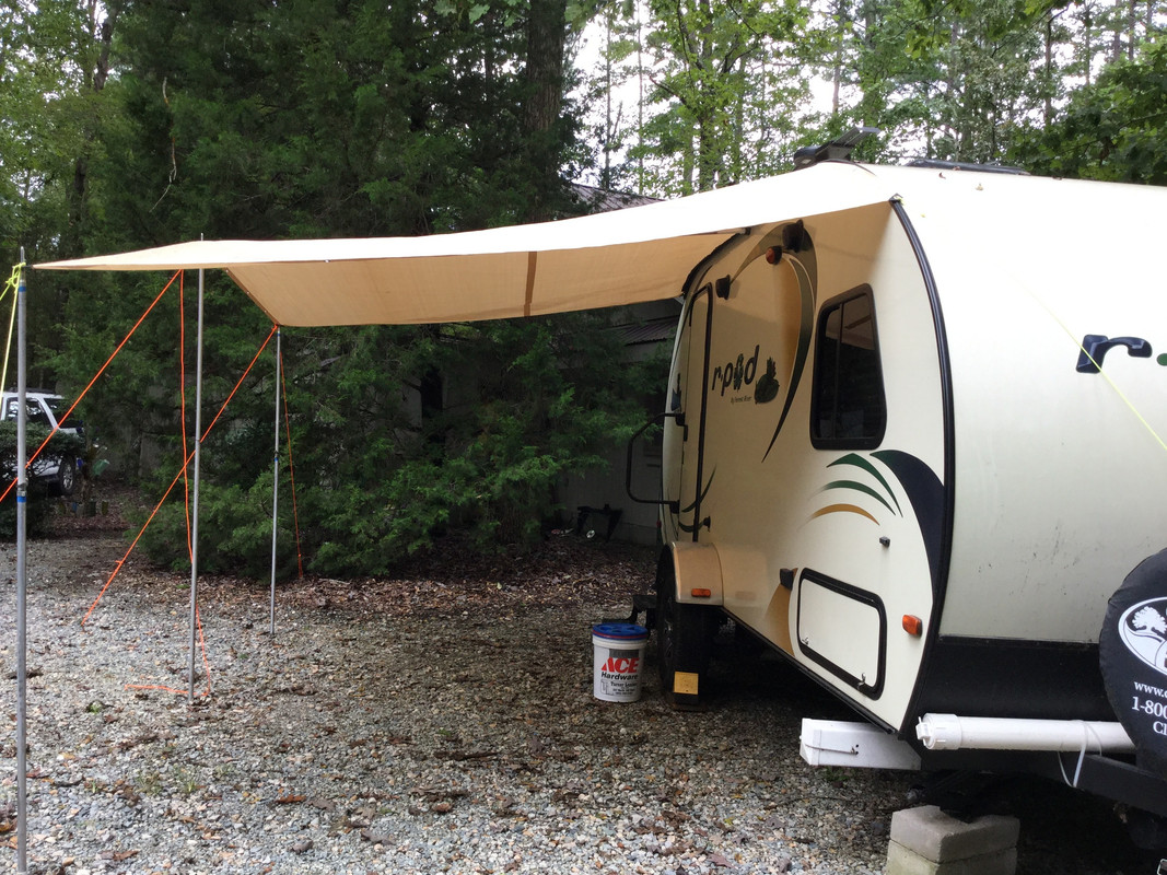

New Tarp/Awning for our R Pod 179
Laura and I just finished making a new awning for our 179.
 We started with a tarp and ended up with an awning. Actually, this is our second attempt.  We made an earlier model using sail slugs that were zip tied to a tarp that we already had.  It worked, but not very well.  The slugs got caught up in the rail, they bunched up and were just not acceptable. So, we started over using keder welting that Laura sewed onto a tarp.
 We purchased a 10’x14’ tan tarp from TarpsNow.com.   They were the best place that I could find for heavy duty tan tarps (we wanted tan to go with our exterior color).
The finished size was 9’6” out from the Pod and 13’6” along the keder rail.  Our keder rail measures 12’long, so we ended up with about 18” of “extra“ tarp length that overhangs evenly approximately 9” on each end.
 I ordered the keder welting from Keder Solutions   (www.kedersolutions.com) .The rail on our 2015 179 measured 14mm, so I ordered 13mm keder welting.  It cost $5.02/yard plus shipping.  It was exactly as pictured and the order shipped quickly.  It is a stiff plastic core with a 2” edge for sewing.
 Laura sewed the keder welting on the tarp with 3 lines of stitching.
 The keder welting fit perfectly in our track and slides smoothly.  One of us can stand on the steps and feed the awning from the rear while the other one stands on the ground and pulls it along the rail toward the front.  We don’t need a ladder to install the awning.
 We had the aluminum poles from our other camping activities and tarp setup, so we did not need to purchase them. We used 3 adjustable poles for the outer edge.  Each pole is in a reinforced grommet on the awning edge.  We used 3 short sections of aluminum poles to create a ridge that went from the RPod out to the outer edge of the awning.
 The ridge pole is attached at the awning edge with a joint made from an assortment of ½” PVC fittings and a 3/8x3 eye bolt and some washers. This was the hardest part of the whole project.  I fabricated this piece so that the vertical pole holds the edge of the awning and also connects to the ridge pole.  The PVC joint is made so that is can swivel up and down to accommodate different ridge angles when we raise or lower the center vertical pole.
The Pod end of the ridge pole rests in a ¾” PVC sleeve.  We used a 3/4” end cap  that was sewn onto the tarp when the keder welting was sewn on and a short piece of ¾” PVC pipe to extend the length.  We insert the tapered end of the aluminum pole into the PVC receiver.
 Once the awning has been installed and the poles staked out, we tie each end of the awning that is in the keder rail to the R Pod.  We tie the rear line to the rear driver side stabilizer and the front line is tied off on the A frame.  This keeps the awning tight  in the track and will not let it slide front to back.
 We store the awning by rolling it and putting in a drawstring nylon bag under our bed.  We store the poles and stakes in a 6” round PVC pipe with screw ends that is attached under the frame and behind the steps.
  We put the awning up and down several times while constructing it.  We can do it now from start to finish in about 10 minutes.
 We put the awning up at home knowing that rain was coming—we wanted a “real world” test before we had to really count on it during a trip.  Well, the rain came and so did the wind—lots of rain.  It stood up with no damage and no problems.   So I feel pretty confidant that it will hold up and be useful for us. It was a good project.
 I hope this will be helpful to others and I’m happy to answer any questions. I also hope the pictures worked-I never know until the article is actually posted--and then it is too late to change them. You can click on the picture to enlarge it.

I should have mentioned several other things that Laura just brought to my attention.
The keder rail that came on our R Pod is the same rail that will carry our R Dome. There are 2 different sizes depending on your year model.  the newer models come with either a keder rail or a roll out awning.   They are not interchangeable.
We also own, use and love our R Dome.  It fits in the same rail as the new awning. We usually use the R dome  when we are staying somewhere for several days.  We wanted an awning because it was quicker and easier.
As I mentioned, the keder rail is 12',  the finished awning is 13'6". We put keder welting along the entire length of the awning. Therefore, the new awning can be moved 18" front to back in the keder rail to shade the complete bedroom window as well as the door.
Vann
