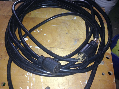

Cord: male end to 30 AMP generator  port:

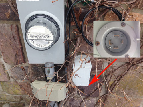

30 AMP Port on outside of house: female end of cord

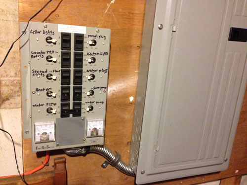

Transfer switch panel next to and wired to main breaker panel:
My routine is to hook cord up, start generator, go to transfer switch all breakers to generator. Not quite automatic, but not bad...and safe. I've been pretty good at guessing when the power might go out, so I hook the generator up and if the power does go, I simply push the start button on the generator and switch the breakers to generator. I do keep one (light) circuit on mainline power so I know when the power comes back on. I have a neighbor that didn't realize power was back and ran his generator for two days after power had been restored!
