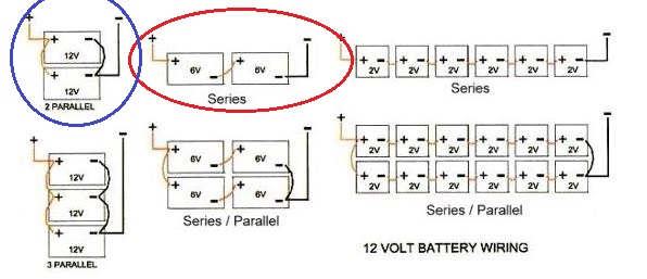

The best solution is a pair of 6V GC2 golf cart batteries wired in series. The only issue might be the size of the rack on the 179. It used to be OK for the pair of GC2s in boxes but I don't know what's rolling off the factory floor now. Either way it's an easy fix if needed. Electrical hookup is the same as the 12V battery but gives you about 2.5 times as much stored energy.
As of 2016, two GC2 batteries with cases will fit fine on the rack. The lids barely make contact with the rock guard.

Any trick to wiring them in parallel?
Let me clear up some confusion. Two 12V batteries are wired in parallel; two 6V batteries are wired in series. In the diagram below the parallel  connection is circled in blue; the series connection is circled in red. In parallel you add the AH capacity but the voltage stays the same. In series you add the voltage but the AH capacity stays the same. Two 6V GC2s in series yields 12V at 220+ AH. Clear as espresso? Wink
Charlie

Actually that makes sense. Thanks for the diagram. So a negative to a positive to connect the two in series. Think I got it. Thanks again. Maybe I'll just go this route.
