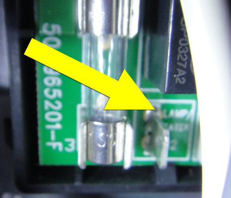

Pulled J2 and the fridge light went off.
I am hoping for success!

That picture looks like J2 is Romex, usually used for a 120 volt connection...

Can't disagree, Doug, good observation. Certainly looks like Romex, but may still be used on 12V circuit. This is hard by remote control Cry .
Maybe Holly can do the following:
  1. Verify the connector really is J2.
  2. Determine where the black wire in that cable with the red wire goes. J number or terminal block? The diagram we're working from shows it might go to J10 or a ground terminal.
  3. Find a similar diagram on the fridge and post a good clear picture.

No panic, just a consideration. Doug (Techntrek) has a good point. First, double check that the thing the red wire goes to is really labeled J2. Second, trace the associated black wire as far as you can and see what it's connected to. A picture helps. If you can post  the diagram that would help too. And, yes, the meter will solve it all.

Okay, just went out there and took the back thing apart again (I'm getting good at that detail...)
Where I pulled J2 is clearly labeled, albeit in TINY and Out-Of-Focus font, LAMP/HEATER.
So, I'm good, right?
Also, that thermo-whatever thing that slides up and down on the fins has a  fat white wire connected to it.

Yes, you're good to go. And if you can live without the light you're done. The ammeter will still be required to reclaim the light function. BTW, do not discard or return the meter. It's still VERY useful Wink .
