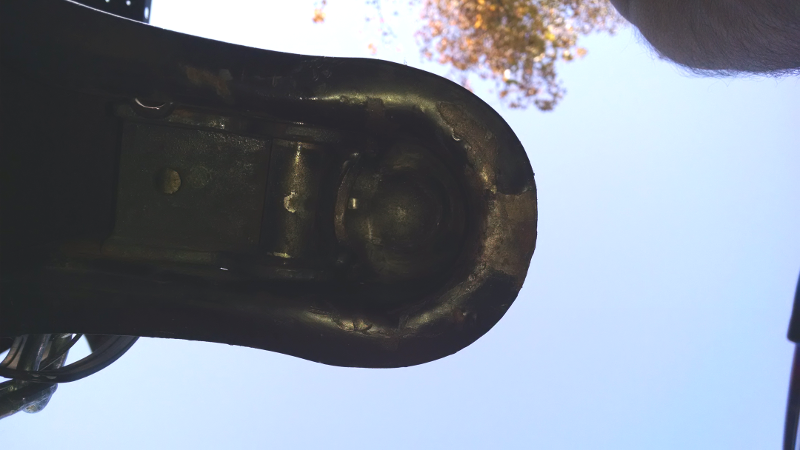

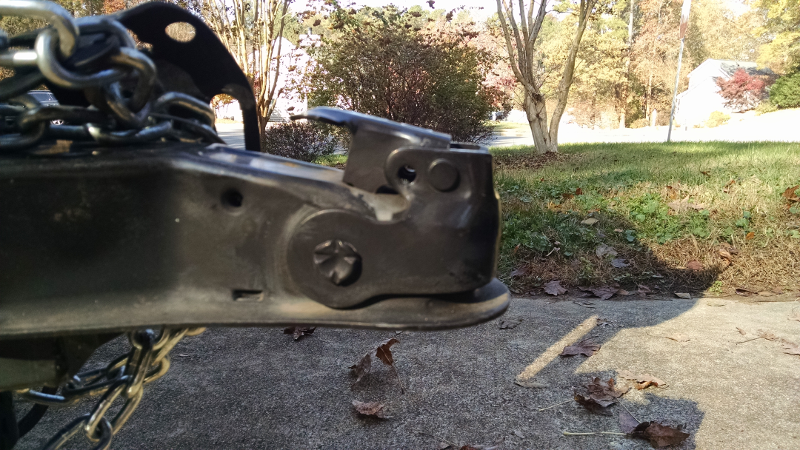

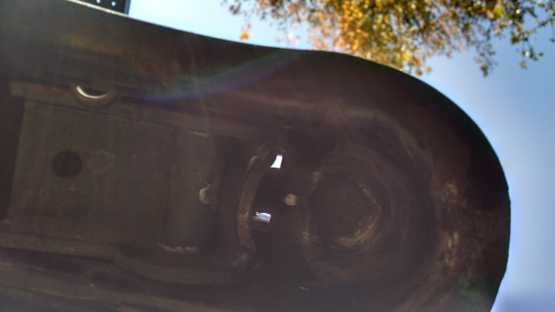

I would not rule out a worn or defective coupler. Here are some pictures of mine:
Latch open:
Plate slid back:
Latch closed:
Plate slid closed:
As you can see, when the coupler is latched and the plate is slid closed, there shouldn't be room for the ball to pass through the opening.
