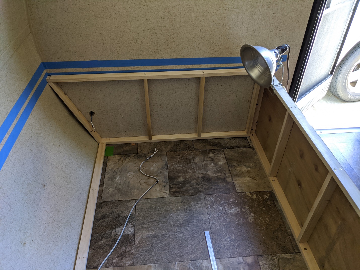

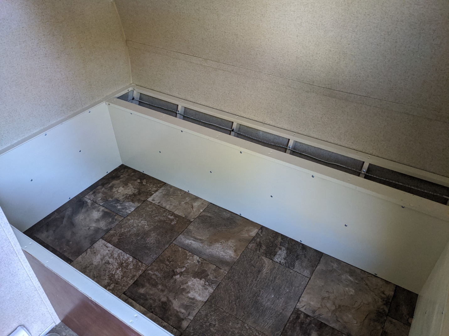

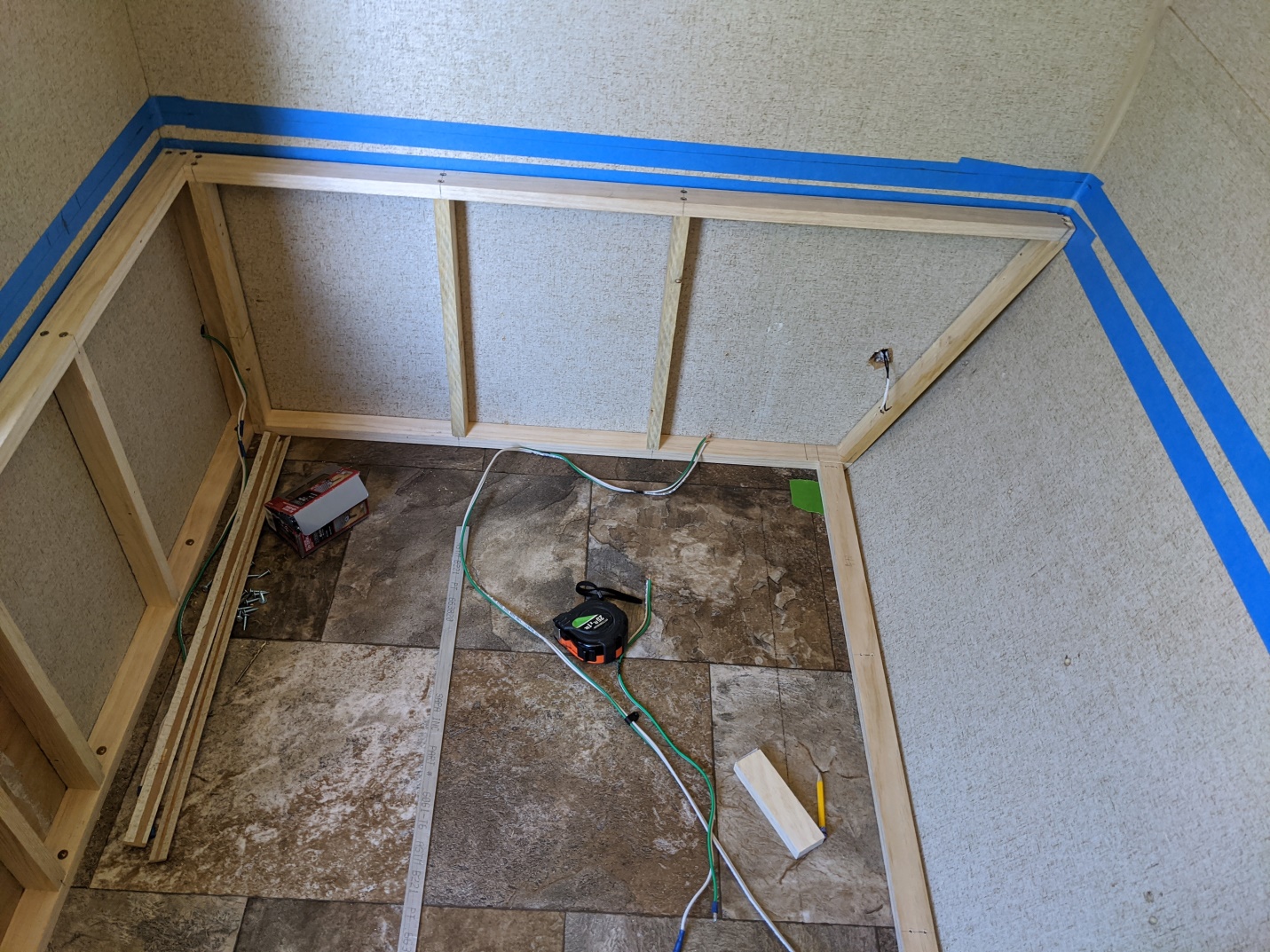

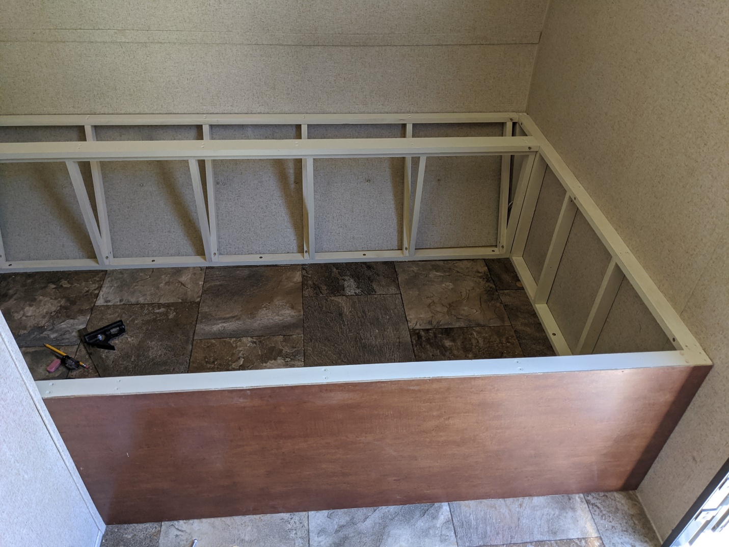

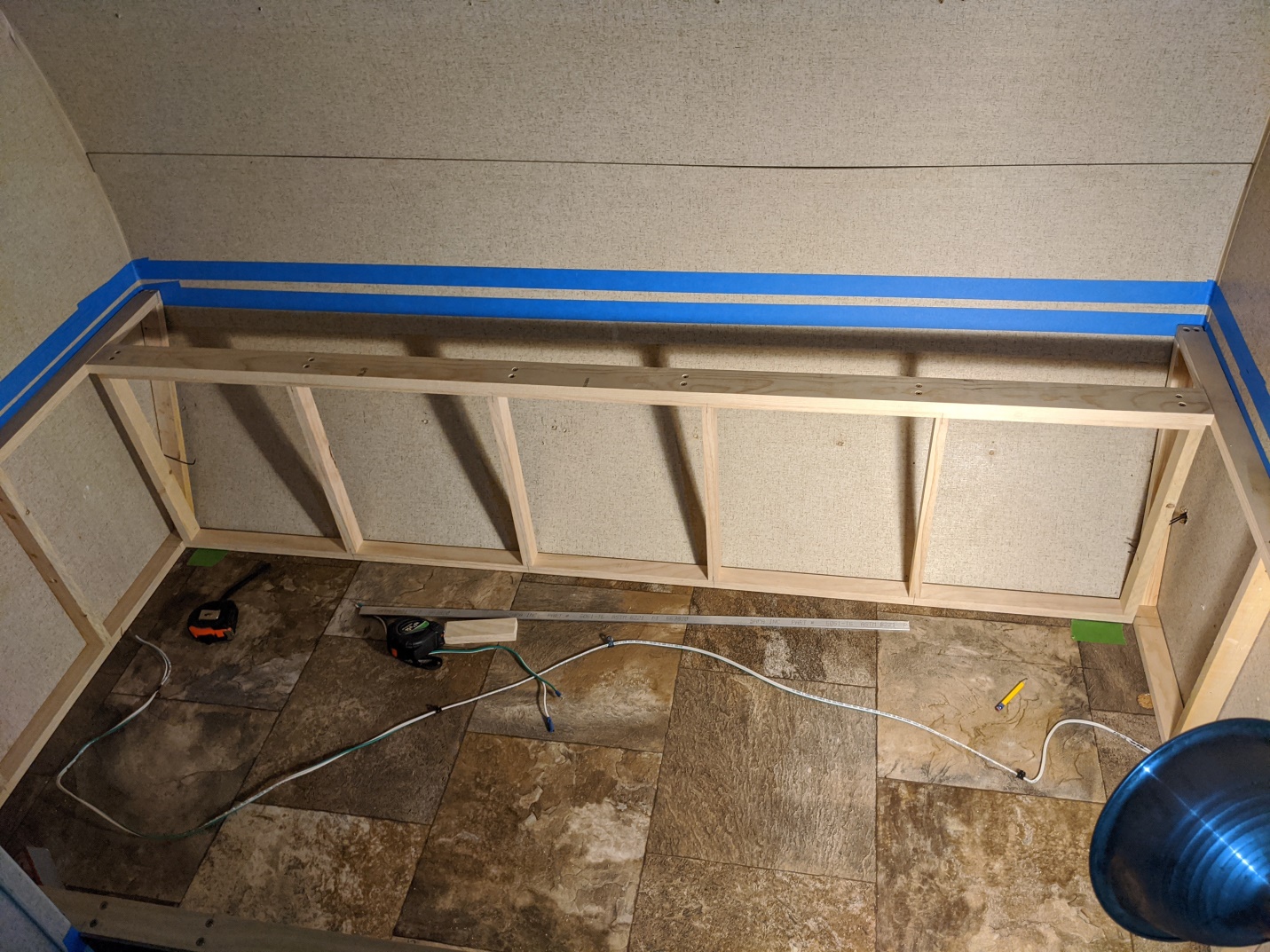

Well I started removing both bunk beds over the past weekend and building a new bed platform at a height of 18" which will change the bed width from 44" to 46" and every little inch counts. I've changed the original design and now it mimics USA house construction with 1"x2" studs at less than 16" on center. The stud wall supporting the bed will go all the way around the perimeter and I think will double the weight bearing ability of the bed without adding much weight. I'm doing lots of precision cutting with my chop saw and table saw since the two sides are not exactly symetrical. It's very time-consuming, but I think the final product will be worth it. It really changes the feel of the bed area, much less claustrophobic.
abikerider ![]() Newbie ![]() ![]() Joined: 25 Dec 2022 Location: CA Online Status: Offline Posts: 25 |
Here are some pics of the new bed frame being built. I used the paneling that was on the bottom of the top bunk for the front of the bed to match the other cabinets. The frame height is 18 inches. Still painting the plywood for the top so I will show that next.
