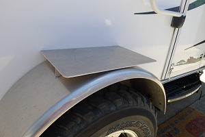

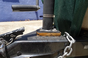

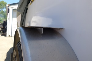

Fender table and jack spacer
I made a small table for my fender to hold my radio and drinks. My first attempt was the thin aluminum pieces with the bend it. It was made from a sheet of 1/16” thick 5052 aluminum I picked up at a scrap yard. I wanted a soft aluminum I could easily bend by clamping it to a table and then tapping on it with a rubber mallet to bend it. I then used the top part of my belt sander to smooth out the radius cut so it fits flush with the fender. You are limited to what the yard has in sizes and so I bent it and mounted it with 2 screws thru the fender and some adhesive sealant on the underside edges next to the wall. It worked great but it only was big enough to hold the radio. I went thru my scraps and found a sheet of 1/8” that I cut down to attach to the angled piece. The only thing holding it on are the 2 flat head screws and a dabs of adhesive on the corners. It is now big enough to hold everything. The spacer for the jack is ¾” oak flooring with a clear urethane coating. I wanted to have a little more clearance when exiting driveways.

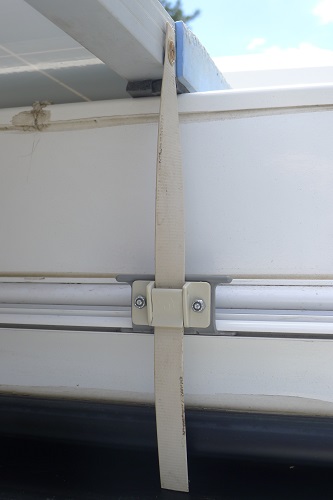

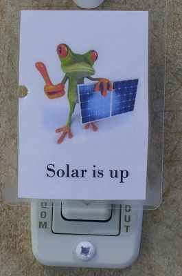

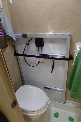

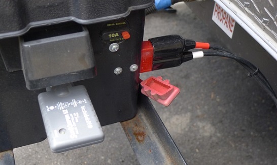

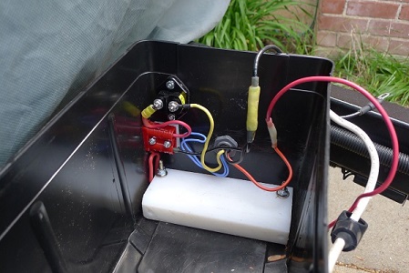

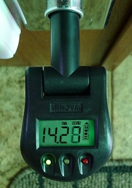

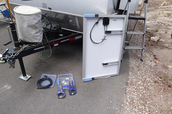

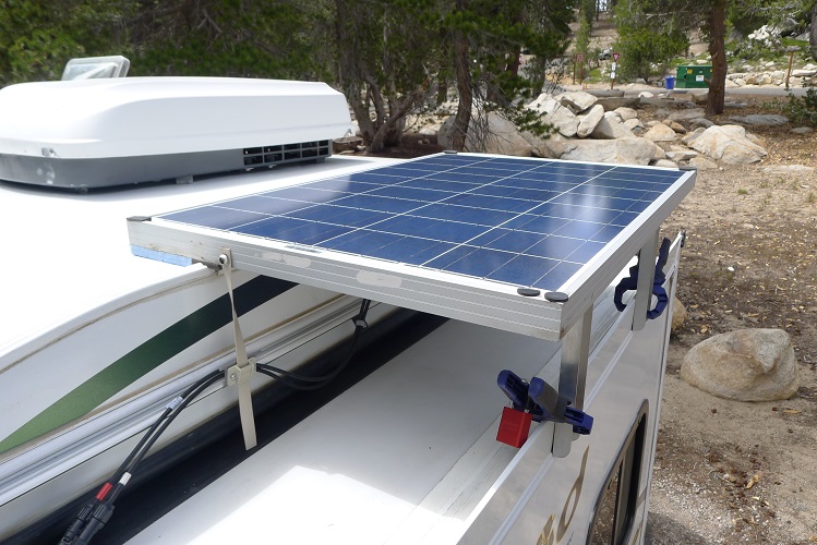

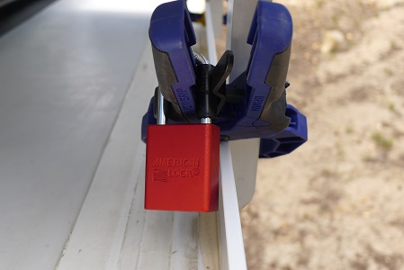

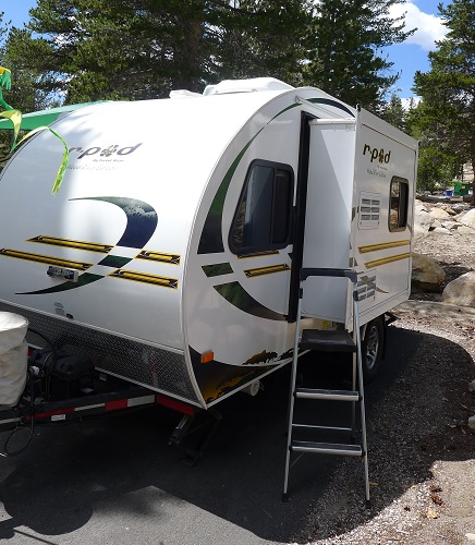

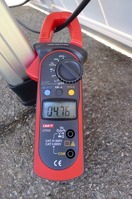

Solar Panel
I purchased a Grape Solar “GS-Star-100W”, 100 watt panel from Costco and a group 27 battery. I had to get a new battery box to hold the bigger battery and to also mount the charge controller and circuit breaker. The charge controller is a Morningstar “SK-12 SunKeeper” 12 Amp PWM Charge Controller. They make a 6 amp model but someday I may want to add a second panel so I got the 12 amp. To hook it up to the panel and battery I used an Solar Panel Cable - 30ft long, 12 AWG wire, with Mc4 connectors. I cut the cable in half and attached it to the Anderson multipole power connector, SB50 series, 50 amps, 10-12 gauge wire contacts and added a dust cover along with a Bussmann 10 amp panel mount circuit breaker “25510-B-2”. I carry a step ladder in my rear pass thru hung from a wood slats. I need the ladder to install the panel. The solar panel travels in my bathroom strapped to the wall; it’s not a problem if it gets wet. I haul everything out to the side of the trailer and extend the 2 legs that are attached to the panel with hinges. The panel weighs 20 pounds so it helps to have some hand it up to you. I have installed foam strips to the frame of the panel so it won’t damage the roof or edge molding. I use 2 Irwin Quick Grip Handi Clamps to attach the legs to the slide out frame. I trimmed off the ends of 2 Camco Party Light Holders and super glued them together to so I could attach the cam from a “Parent Units 2 Pack Topple Stop Furniture Straps” I got from Amazon. The straps I attached to the side of the solar panel. I put a lock on the Handi Clamp to make it harder to remove the panel; the back tube on the lock was to increase the diameter so you can’t operate the release mechanisms on the clamps. I route the wire down the side of the trailer to clips, I have replaced most of the plastic ones with metal one because the plastic ones snapped off. If shade is covering the top of the trailer I can position the panel on the ground.
Group 27 battery and charge controller wiring
Charge controller, Anderson connector and circuit breaker
Ladder storage
Secured in the bathroom for travel
All the parts and the installation
Lock to make it harder to remove and straps to help hold it in place if there is wind
Because it is not bolted to the roof I can move it to get the best sun
Warning label so you do not run the slideout
Mt. Rose Campground last Thursday had good sun so the battery's charged, on Friday their was over cast so it didn't charge as well
JandL
