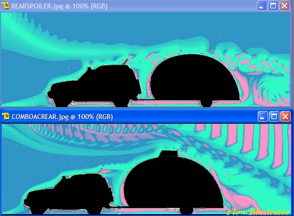

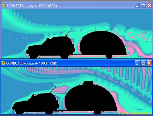

Flow...with and without the A/C...with the spoiler at the rear and a 30" spoiler at the rear
Direct Link To This Post Posted: 16 Oct 2009 at 9:22pm
Note how many pressure pulses are produced by simply adding the A/C to the roof.  There is a build up not only much higher at the upper rear...but also a pressure field out in front of the R-Pod.
I think that the A/C on the RP 170+ units with its longer roof line and using a longer and higher
TV helps keep the flow much smoother (see Outbound's flow images at the beginning of this thread).
It appears that by moving the A/C to the roof of the RP-151, Forest River really decreased the
efficiency of the RP-151s.  I wonder how much less mpg I will be getting from the 2010 Pod versus
the older units?

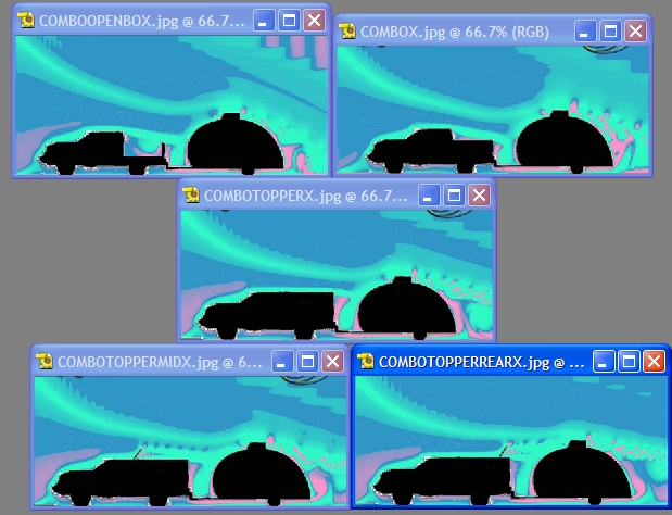

A comment was made about airflow over a pickup truck... I used a 2010 Ford Extended Cab with
a length of about 221 inches.
The first image is an 'open box'...Flow Illustrator does a two-dimensional analysis, so the PU box
looks like an open box with a tailgate on the end: suprisingly the flow was quite smooth over the R-Pod...the open box not doing much to the flow.  There were large amounts of pulsing behind the R-Pod and upward from the pavement behind the rear (suggestion...cover the box!)
The second image is a 'closed box'...a covered box...there were some lower frequency pulsing
at the top rear of R-pod and some rear pavement upward pulses
The third image is with a truck 'topper' covering the box...there was also some pulsing at the top rear of the R-Pod the rear upward pulses were more gentle
Putting a 20 inch wind deflector at the back of the pickup cab suprisingly caused both pulsing at the top rear and lower rear of the R-Pod...not very efficient flow
Moving the wind deflector to the rear of the topper really smoothed the flow...no upper pulsing, no longer period pulsing, with a nearly constant low pressure zone at the lower rear (probably the
most efficient flow of any of the cases!)
