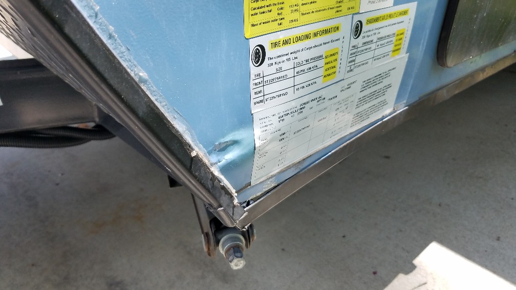

I glued up the last bit and it seems like everything is solid now.....not perfect maybe 90%.  I am looking into how to fix the front corner where all this started.  They cut the under railing at that point so there are no screws holding the last 6" of rail.  I am going add a piece of 90 degree steel and screw it to the frame to support.  Will add pics when I get it done.

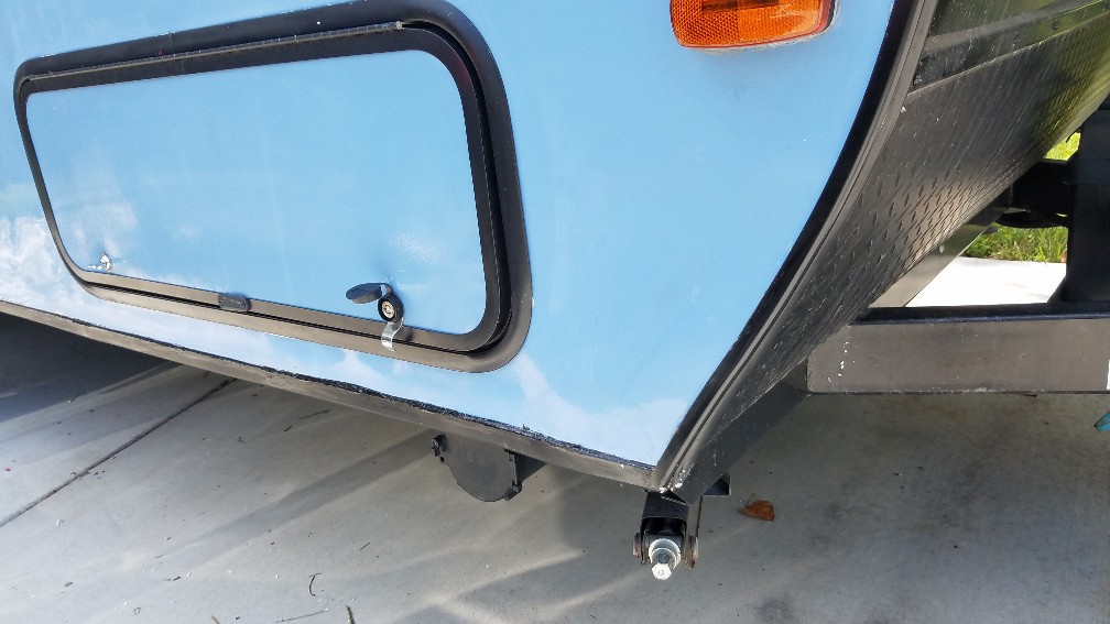

I was able to finish this section of the repair.  Came out pretty good.  I had to get some paint for touch up and found that was not easy.  Forrest River gave me the paint code but no one here was able to mix it.  I had to go thru the folks that mix it for FR.....$50 for a pint.
What you will find on the lower railing is FR used very little caulking on outside edge to avoid clean up. This is another issue as to why it didn't hold up.

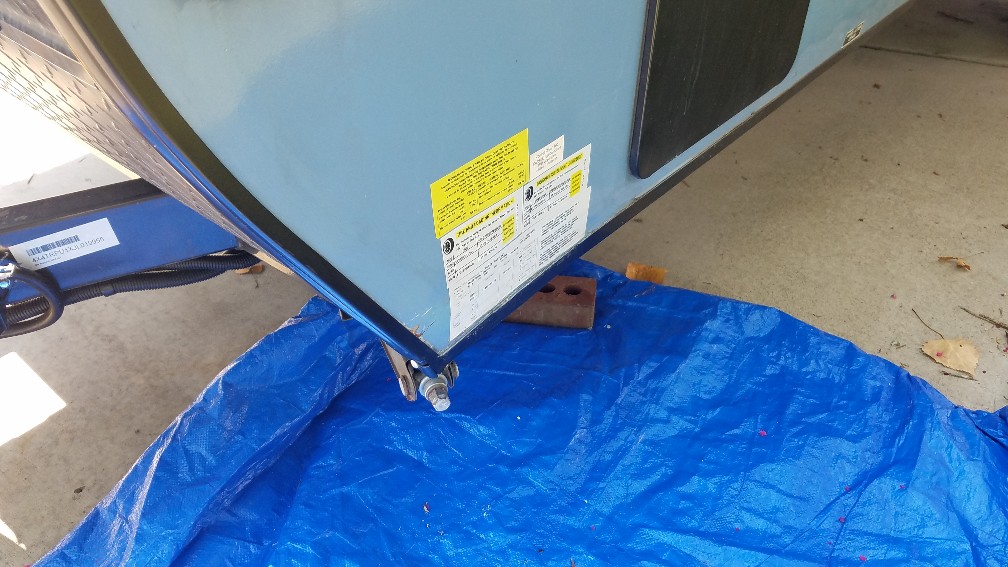

Next up is fixing the other side

Okay got it done.  Fixed the delamination then resealed.  When I put it together I used stainless screws and washers for extra holding power.  The holes tend to distort the aluminum from tightening which is why I used the washers.  FR had not put a screw in the last bit of the under railing which is why it let go. Honest to goodness they use some of the crappiest plywood I have ever seen.....looks like luan underlayment.  I still have to fix the crack in the fiberglass....should be an easy fix...hope the paint I have matches.
