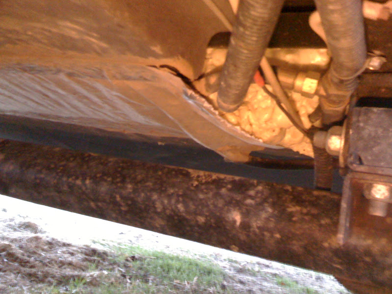

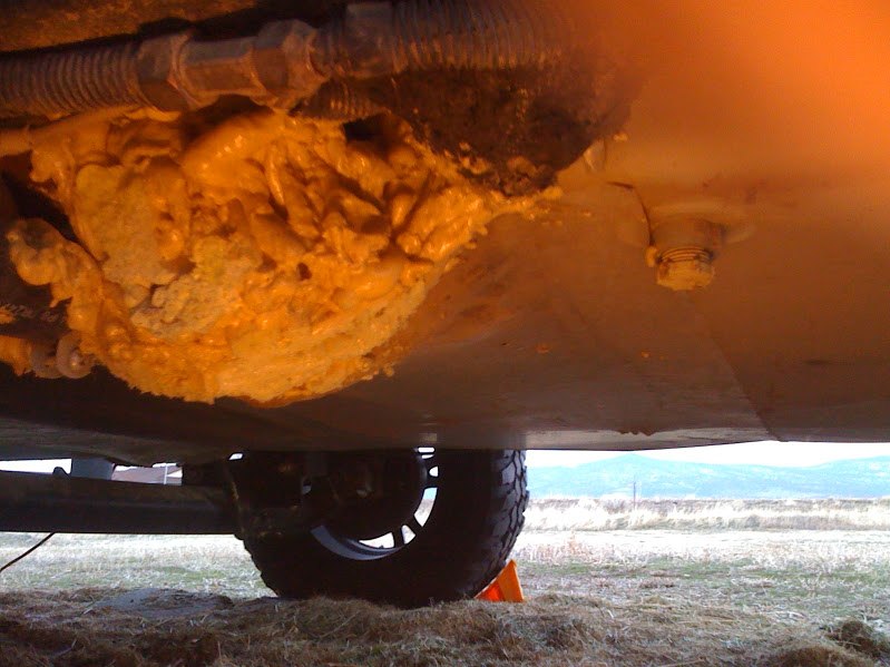

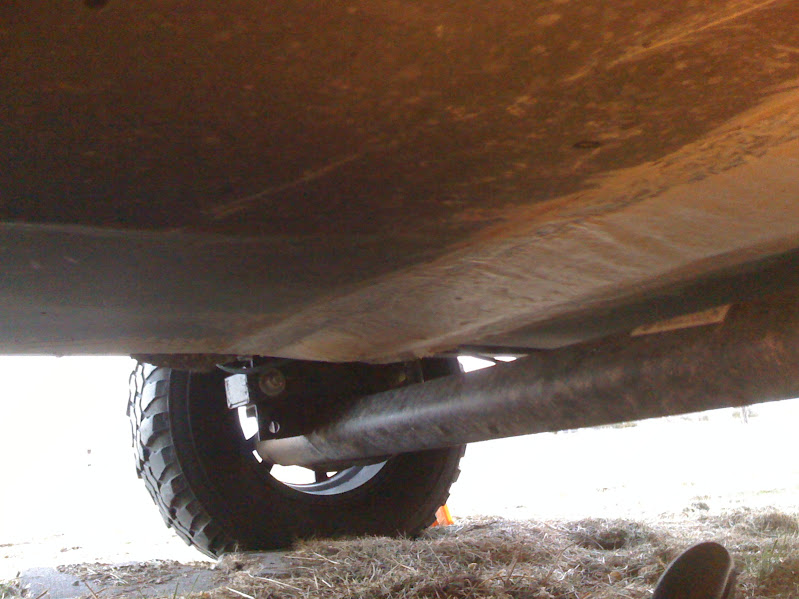

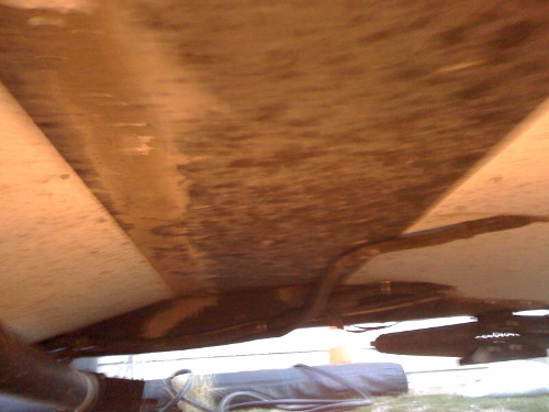

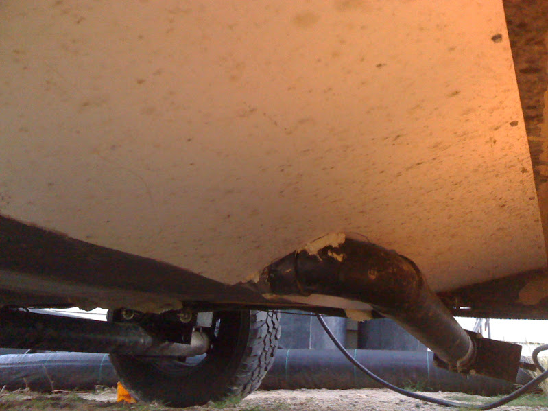

Let's see if images will load:uploads/4717/podundermod7.JPGuploads/4717/podundermod6.JPGuploads/4717/podundermod5.JPGuploads/4717/podundermod4.JPGuploads/4717/podundermod3.JPGuploads/4717/IMG_0650_500x375_500x375.jpguploads/4717/IMG_0650_500x375.jpg
Remember now, this project was done in a hurry before departure and was to be the first prototype.  The middle section was done using 8 ml visquene.  The other material is the same stuff that is in the r pod screen door- (1) 4x8 sheet.
