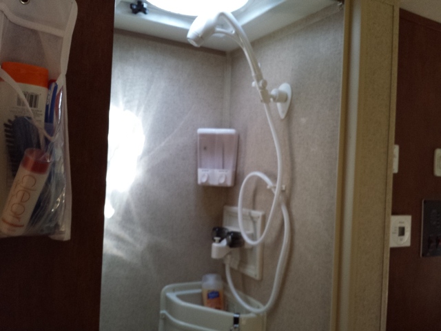

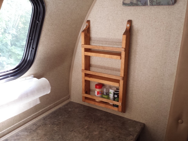

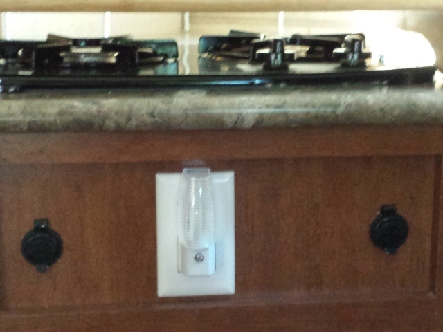

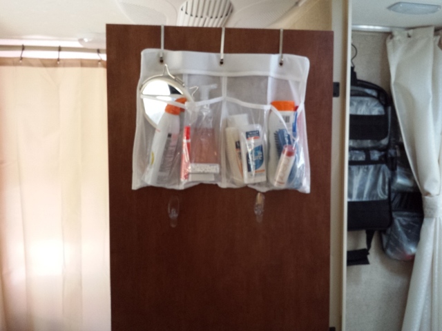

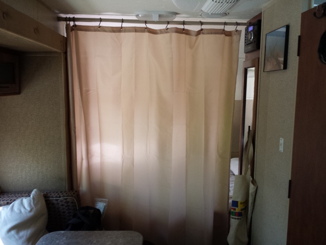

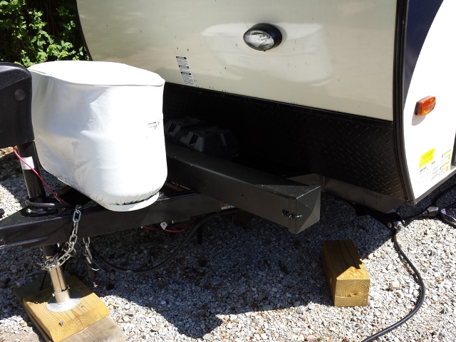

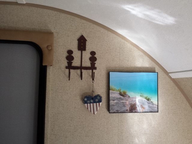

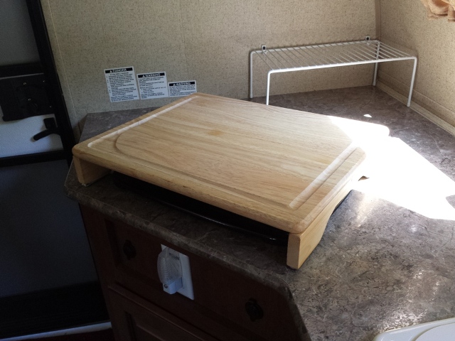

A few Mods:
Bedroom Curtain
Spice Rack
12v usb and cigar ports
Cutting board over gas burners
Bathroom hooks to hold shower bag, etc.
Key and hat rack
New shower head
Sewer hose holder, holds two 10 sections and plastic joint.  I left the old sewer hose in the original holder for dump station purposes.

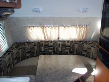

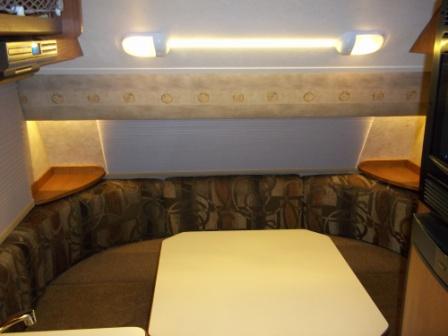

I had the same issues with the curtain. Two problems: The screws used to install the tracks are too large and improperly placed so the curtains do not slide easily. Secondly the tracks are too short so they block half the window when pulled open. I fixed both problems by replacing the track with two 3 foot strips on top and two on bottom, to provide two 6 foot tracks. The original slides and curtains were used. Installing the tracks with #4 screws outside the slide slots made the curtain slide properly. The extra length allowed full view of the window.
This is the best picture I have:
The track is similar to:
http://www.rvdesigner.com/prodview.asp?ci=2&pi=88
Posts: 1004

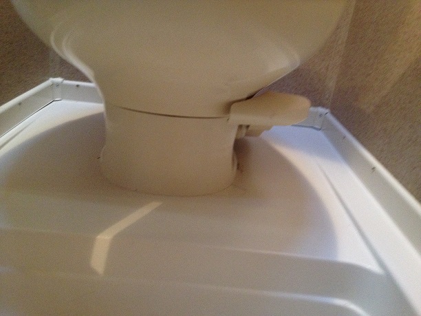

Post Options Post Options   Quote marwayne Quote  Post ReplyReply Direct Link To This Post Posted: 14 Jun 2014 at 8:09pm

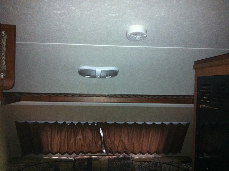

before
after

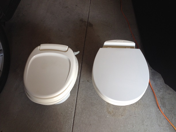

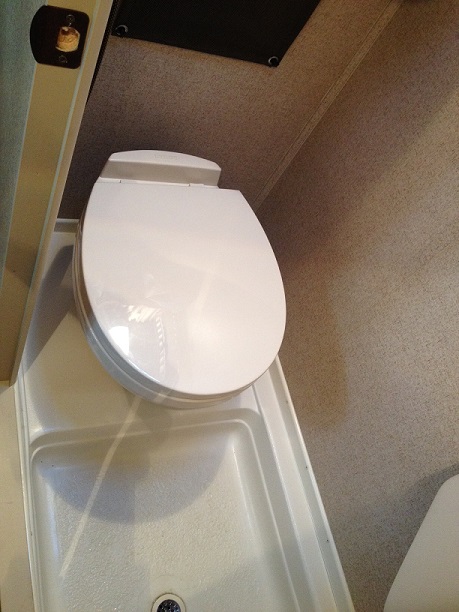

Changed out the toilet with a more residential type. Much more comfortable now and do not have to reach over the toilet to flush it.
Side by Side

I like it.  How much was the new toilet?
