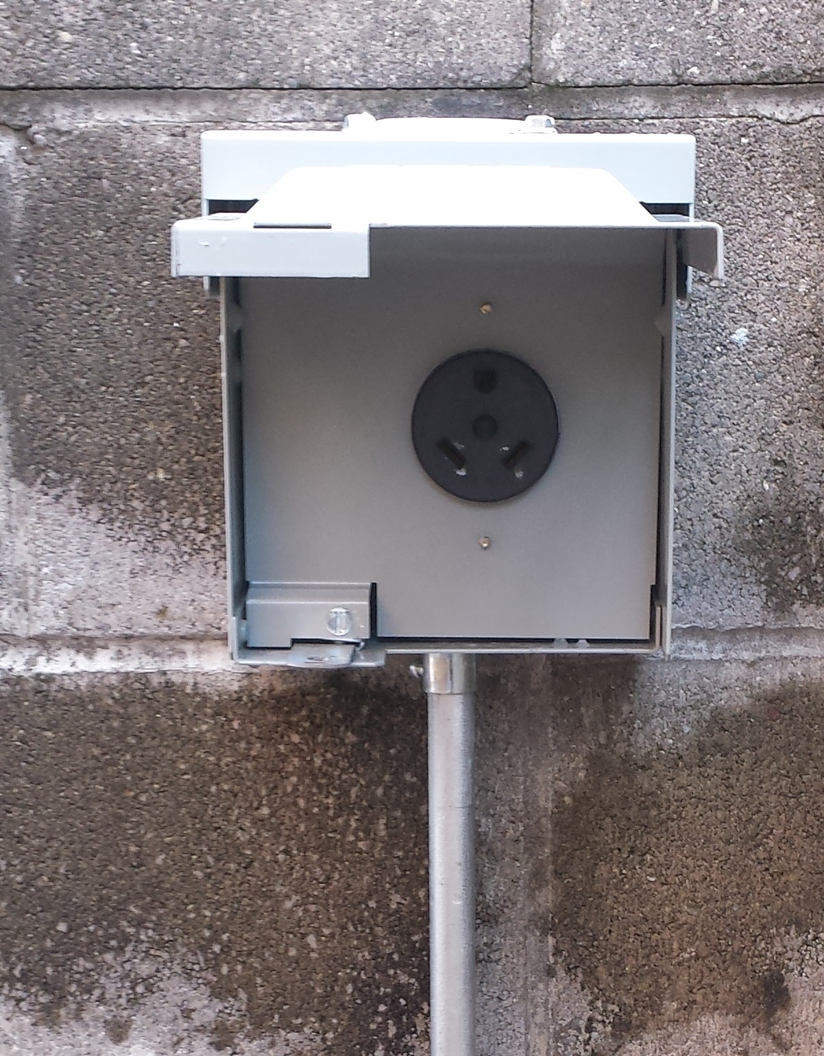

Pics or it didn't happen.  Tongue
It does make things easier when you get home from a camping trip and want to plug in quickly, or when you are ready to pre-cool the fridge and load up for a trip when it is 95 outside (so you can turn on the A/C).

Direct Link To This Post Posted: 10 Aug 2016 at 3:42pm
well today I finished installing a 30amp service dedicated for the camper.
A/C works like a champ
