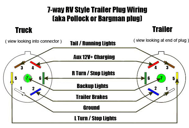

Dear R-Poders,
Just starting our second season on a 172. Before leaving town on an overnighter, I charged up the battery and left the cord plugged in for a few days. Fridge got nice and cold. Then we took to the road, and when we got to our destination, battery was almost completely dead. Didn't even make it through the night. Next day coming home, noticed that even with a two hour trip, the battery didn't charge up at all. Did I forget to flip a switch or something? Is there something wrong? Any advice more than welcome. Enríquez, from Burque (Albuquerque) |
Enríquez
How many times has the battery been left to go dead? Since you say you "charged up the battery", does it sit, hooked up to the pod, but pod not plugged in when not in use? Do you know for sure your tow vehicle is sending a charge to the pod? |
Yup, sounds like either the charge line is sized too small. True for most factory and aftermarket installations which all use 12 gauge when you need 10 or 8, I've shown the voltage drop numbers here many times. Or there is no charge line. It is easy to upsize the line or add one.
But, I always recommend propane on-the-road. As for filling up at a gas station with the fridge on, it isn't something to worry about. Gasoline has a narrow flammability range and any fumes that escape are quickly diluted, and as mentioned above it is heavier than air so it hugs the ground while the flame is 2 feet above the ground.. That said, all modern cars and trucks have built-in vapor recovery systems to prevent the fumes from escaping (the gas pump vapor recovery systems are being phased out because of this). How many gas station explosions do you hear about on the news?
Enríquez ![]() Newbie ![]() Joined: 31 Mar 2016 Location: Albuquerque Online Status: Offline Posts: 3 |
Any suggestions on how I check if a charge is being sent in from the tow vehicle?
Thanks for such a quick answer! Enríquez
Enríquez
CharlieM ![]() Senior Member ![]() ![]() Joined: 23 Nov 2012 Location: N. Colorado Online Status: Offline Posts: 1797 |
There are several things you can check with a digital voltmeter. With the engine running and the 7 pin Bargman disconnected, check between pin 4 and pin 1. You should see 13+ volts. The voltage should disappear when you turn off the engine.
![]() Next, with the engine running, the trailer connected and everything in the trailer off including the fridge, measure voltage at the battery terminals. Again you should see 13+ volts. If both these tests pass your TV and TT are wired correctly. Please note that, as Techntrek and others have said, running the fridge on 12VDC while driving is marginal at best and may totally discharge the battery at worst. |
