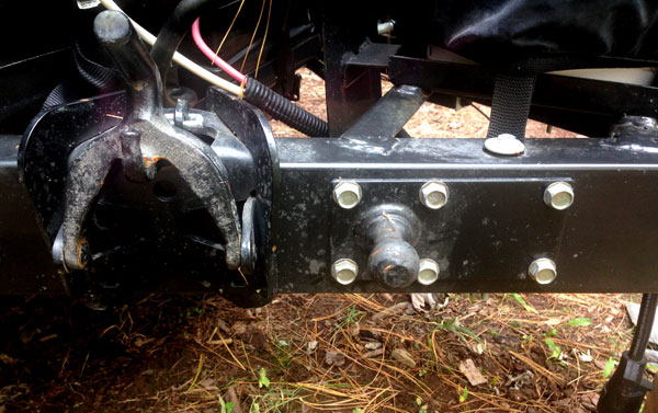

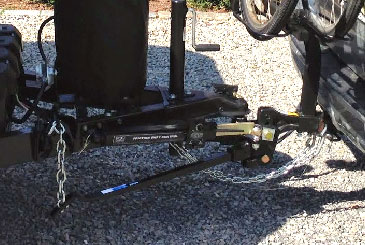

Interesting. My current Reese config: Note friction sway.
Close up of friction sway attachment:
A few emails with Reese confirmed that the Dual Cam Sway would work fine with my wdh head and spring bars. I wonder, however, if it would be worth the effort and a few more holes in the frame?
During our recent cross country trip we didn't have any problems, but I never overlook a little extra safety factor.
Direct Link To This Post Posted: 14 Oct 2014 at 2:25pm
The good news is they use the same spring bars.  The cams fit inside that "hook" on the end, where your chain is currently attached.
Direct Link To This Post Posted: 14 Oct 2014 at 2:29pm
Yeah. Confirmed that with Reese, Doug. I'm a little concerned about hole alignment, drilling additional holes in trailer frame where friction sway plate is now. I really do like the dual cam system, though.
