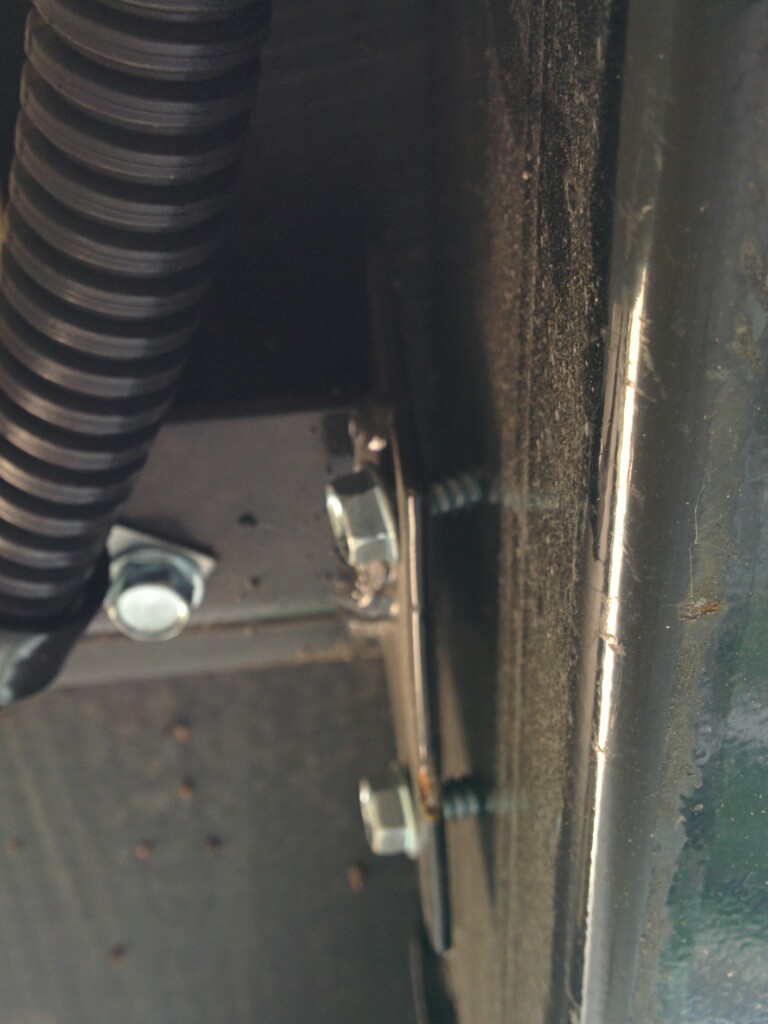

Checked mine yesterday to find all three tanks' brackets were short. Fresh water was nearly 1/2" gap. I added flat washers to fill the gap. Thanks OP for the tip.

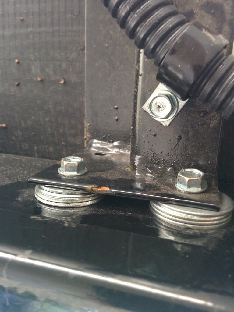

Direct Link To This Post Posted: 29 Jul 2014 at 8:14am
Here is the fix should help to prevent the shearing. Thanks CharlieM

This picture should be hung on FR's Wall of Shame in their QA Dept. I hope someone from FR stumbles across this thread and takes some action in the factory. This is a three point serial failure:
Engineering should have allowed for tolerances and expansion/contraction.
Manufacturing should have maintained specified tolerances and flagged assembly problems.
Quality assurance should have caught the problem and rejected it.
