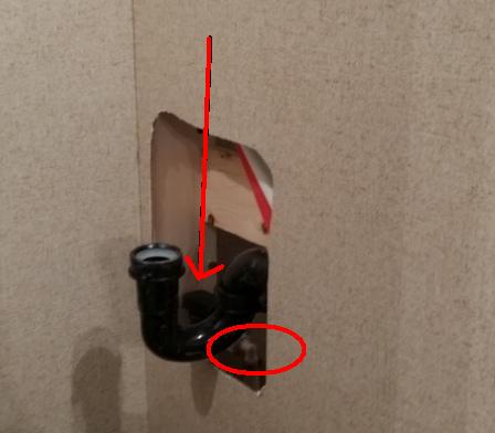

The wall behind the toilet in a 178 is loaded with electrical wires and houses the converter which is the hub for all the electrical circuits.  I don't think it is a good idea to contemplate  adding water lines in that area.  Then there is the problem of installing a drain to the grey water tank.  The sink must be mounted in a corner due to its design, and this could make the sink difficult to use since it would be behind the toilet.
I chose to simply remove the sink, order a wall repair panel from FR, and eliminated the sink entirely.  If (when) we decide to sell our pod, the sink can easily be re-installed in its original position with no evidence it was ever removed.
If you want to scrub your toes, just sit on the toilet as most of us do.

Remove Sink, remove pipes, cap pipe, add wallboard, seal around wallboard.
