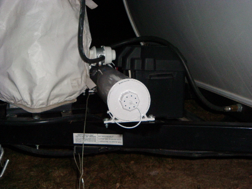

this is what I did after wiping out the front storage tube. By thee way I got the idea from another member
                                          moe

   I like the original low-rider height of the POD, easier for Mother Goose to get in and out of once I moved the step higher. Also moved the sewer hose tube to between the propane tank and the battery box, then trimmed up the tube on the tongue jack a couple of inches to just below the holes on the sides of it.
   This all made for better clearance and have not had any problems since. One thing to remember as you travel is to watch for the rises or dips as you enter or leave gas stations, parking lots or pulling onto or off the road, always take these at an angle, do not go straight over the dip or rise as you will scrape the rear of the POD. Goose
