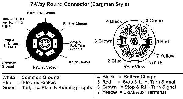

Great diagrams and they should herlp many on the forum.  In years past when I had much larger travel trailers, I would often check various items with the trailer unhitched and a 12 volt battery with short wires attached to the battery terminals.  With the battery ground attached to the Bargman connector, I would check the various lighting circuits by attaching the positive battery wire to the appropriate pin on the connector. Very easy check and simplifies finding burned out bulbs.  I have also used the auxiliary socket to power back-up lights on trailers. This requires running another wire from the TV and the back of the trailer, both terminating in the Bargman connectors.
Thanks again for posting the diagrams.

Direct Link To This Post Posted: 20 Jul 2013 at 11:46pm
Look up the wiring diagram for the Bargeman connection online, then verify that the pin that supplies 12 volts shows 12 volts.  On some vehicles that is only true when the TV is on.  Then make sure the wire that runs to the Bargeman connection is at least 10 gauge wire, not 12 or 14.
